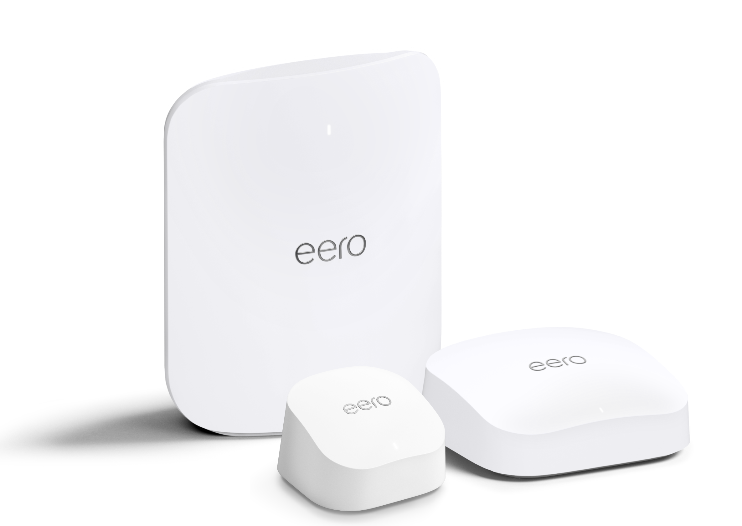

Compatible eero Devices*
  • eero Max 7
  • eero Pro 6E
  • eero 6+
  • eero Pro 6
  • eero 6
  • eero Pro
  • eero

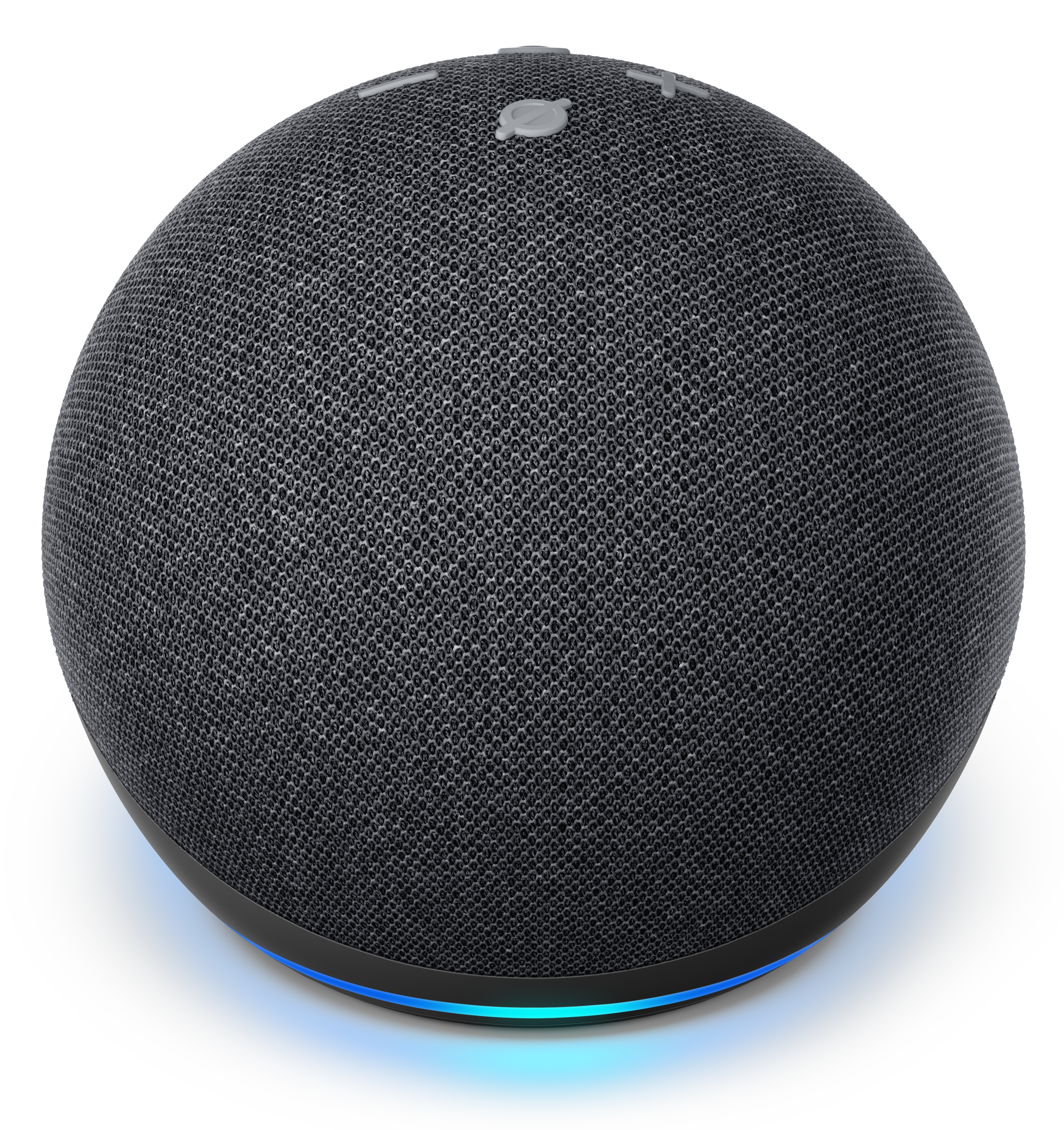

Echo
(4th Gen)
DEVICE GENERATION
Gen 5
Gen 5
Gen 4
DEVICE COVERAGE
Adds up to
1,000 sq. ft.[92m2
Adds up to
1,000 sq. ft.[92m2
Adds up to
1,000 sq. ft.[92m2
SYSTEM PERFORMANCE
Up to
100 Mbps
Up to
100 Mbps
Up to
100 Mbps
NUMBER OF SUPPORTED DEVICES
Up to
10 devices
Up to
10 devices
Up to
10 devices

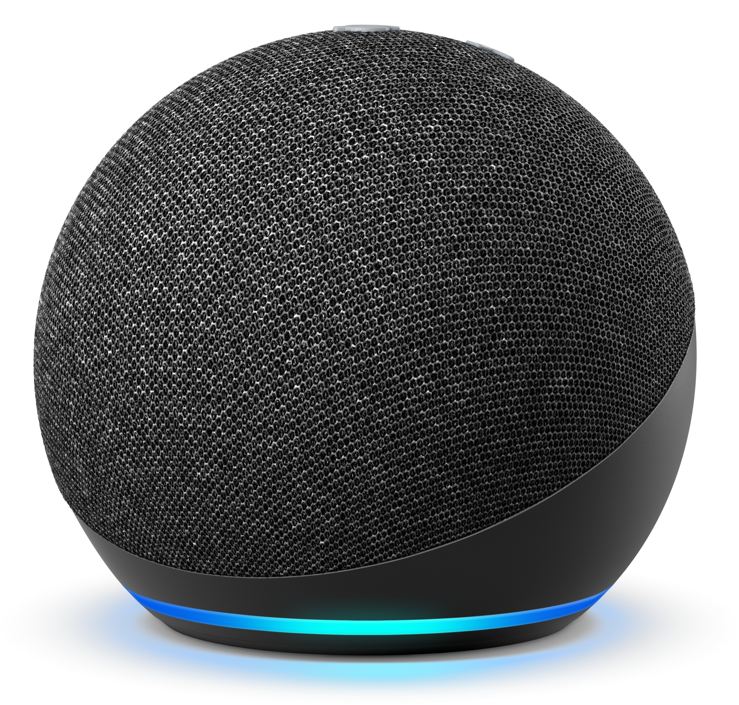

Echo Dot
4th Gen)
with Clock
Echo Dot
(4th Gen)

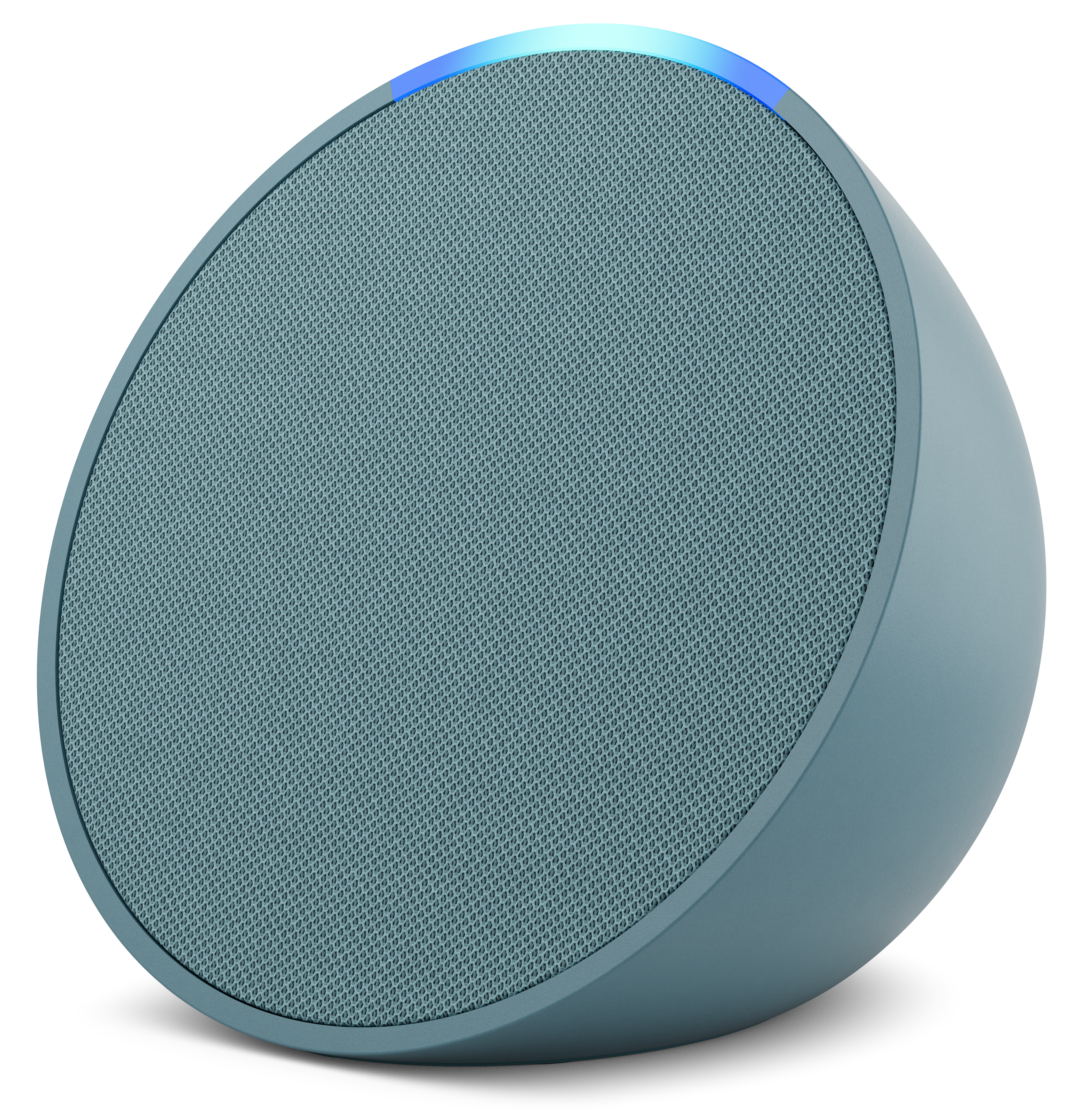

Echo Pop
DEVICE GENERATION
Gen 4
Gen 4
Gen 1
DEVICE COVERAGE
Adds up to
1,000 sq. ft.[92m2
Adds up to
1,000 sq. ft.[92m2
Adds up to
1,000 sq. ft.[92m2
SYSTEM PERFORMANCE
Up to
100 Mbps
Up to
100 Mbps
Up to
100 Mbps
Up to
10 devices
Up to
10 devices
Up to
10 devices

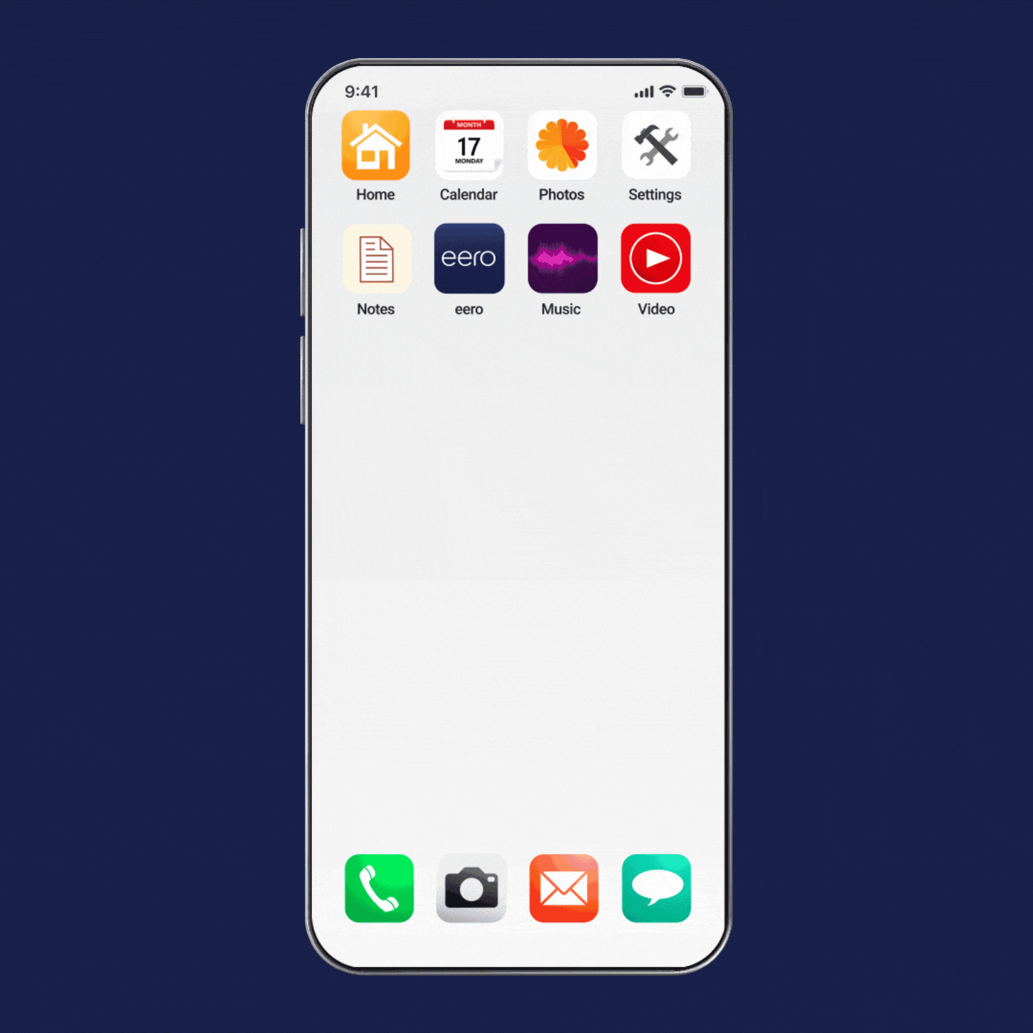

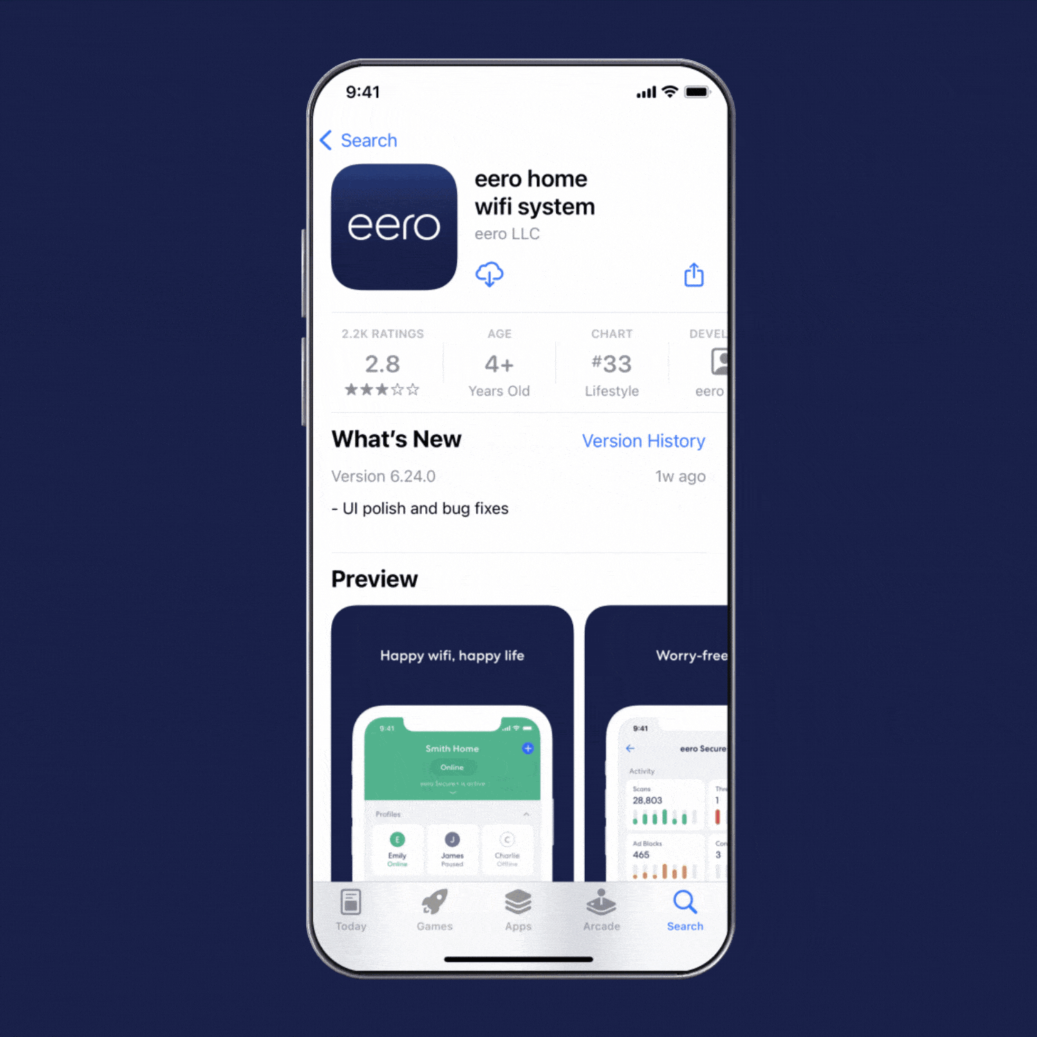

  • Download the eero app for iOS or Android.
  • Tap “New to eero.”
  • Tap “Log in” with Amazon
  • Follow the in-app instructions in the eero app. For more details on how to set up your eero, go here.

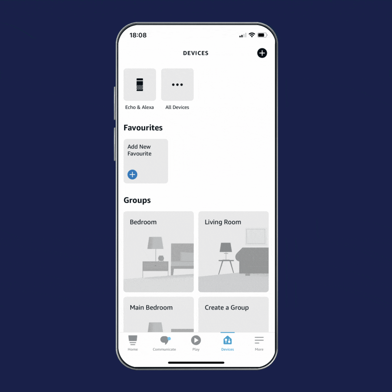

  • If you haven’t done so already, set up your Echo device in the Alexa app.
  • Make sure your phone is connected to the eero network.
  • Plug in your Echo device.
  • Open the Alexa app.
  • Open “Devices” and click on the upper right “+” to add a device.
  • Select Amazon Echo.
  • Select Echo, Echo Dot, and more. Follow the instructions to set up your device.
  • Make sure your Alexa app is updated to the latest version:
  • If you’re on an iOS device, go to the App Store, select your Account profile in the top right, and scroll down to Available updates. Look for Alexa, and update if a new version is available.
  • If you are on Android, open up the Google Play Store, select your Profile at the top right, and select Manage apps and devices. Find the Alexa app, and update if a new version is available.
  • Update your Echo software by asking Alexa, “Alexa, check for software updates.”
  • To verify your Echo is extending wifi, open the eero app, and on the home screen, you should see your Echo in the blue section. Tap on it and see that eero Built-in is enabled and your connection is extending.
