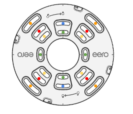

  • You will need to pre-drill 6mm pilot holes for the installation of the plastic drywall anchors
  • Please see the image below to determine placement and screws to use for your installation.
  Slot Screw Size
US – Single gang outlet
6-32
US – 3.5in octagon
8-32
US - 4in octagon and round
8-32
US - 4in square and surface mounting
8-32
EU & UK single gang outlet
M3
  • See the image below for how to install the eero PoE 6 mounting bracket to the drywall anchors
