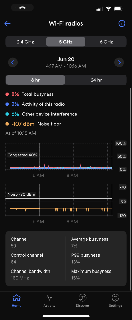

eero App Wi-Fi radios analytics screen showing network busyness data for June 20, 4:17 AM–10:16 AM, with channel utilization charts and performance metrics

What do the busyness metrics mean?
Wireless devices share frequencies and must coordinate when sending data. Channel busyness includes both your eero's transmissions and nearby devices on neighboring networks. We separate these into two categories:
  • Activity on this radio: The percentage of time the eero radio spends communicating with other devices. Many connected or chatty devices (like baby monitors, security cameras, or laptops) increase this value.
  • Other device interference: The percentage of time other devices communicate on the same channels as the eero radio. This includes neighboring networks and other eeros on your network. Check other eeros for higher than normal activity which may be due to a very active device on your network connected to that eero.
Two other important concepts are total busyness and noise floor.
  • Total busyness: The sum of "Activity on this radio" and "Other device interference," representing overall channel busyness.
  • Noise floor: The noise value (in dBm) on this channel. Noise comes from degraded signals (like those over long distances) or interference from non-wifi devices. Higher noise floors reduce signal-to-noise ratio and impact performance.

What are the differences between “Average busyness”, “P99 busyness”, and “Maximum Busyness”?
Channel busyness varies by time and nearby devices, so we provide three calculation types:
  • Average busyness: The average busyness over your selected timeframe. High average busyness indicates a busy home network, many neighboring networks, or both.
  • P99 busyness: Since max busyness only captures the peak, P99 (99th percentile) busyness better estimates peak busyness. The average of the worst 1% of channel busyness.
  • Maximum busyness: This is the highest channel busyness seen in the selected timeframe. Since your wireless environment can change at any given time, this may be due to a brief spike in busyness during the day (for example when everyone returns home in the evening), but can be helpful in addition to the other two metrics.
