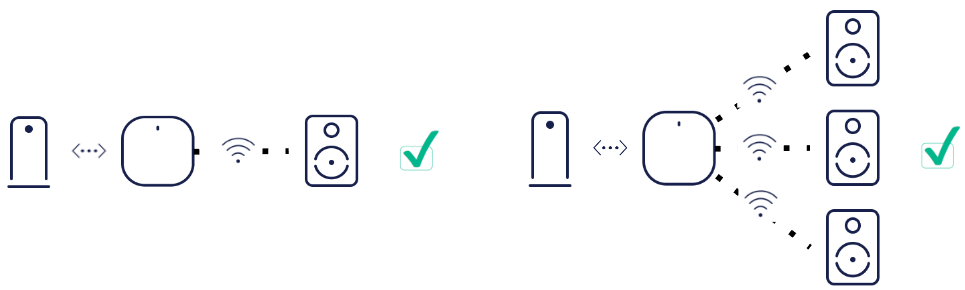

What's the recommended basic setup?
For the simplest setup with optimal performance, we recommend connecting your Sonos speakers via wifi to your eero network. No speakers should be plugged into any eeros on your network via an Ethernet cable. See below for examples.

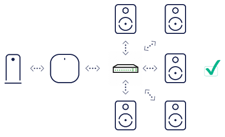

How do I set up an advanced Sonos system?
For advanced Sonos systems with many speakers (5 or more), connecting your Sonos speakers to your network with Ethernet can provide a better experience. When you do this, we recommend that Sonos speakers are connected via Ethernet or wifi, but not SonosNet.
Wiring guidelines
If you're wiring Sonos speakers to your eero network, follow these guidelines for the best performance:
  • Wiring a single speaker: You can wire it to any of your eeros
  • Wiring multiple speakers: Wire them to the same eero or the same network switch. We don't recommend wiring different Sonos speakers to different eeros
  • If you have multiple switches: Wire all secondary switches back to the primary switch, not to an eero
  • Disable wifi on wired speakers: Any Sonos speaker that's connected via Ethernet to an eero network should have its wifi capabilities disabled

Wireless Sonos:
alt
Wired Sonos:
An image with a suggested topology featuring a modem connecting to a Gateway eero. That eero connects to a network switch, which provides Ethernet connections to several Sonos devices, in this case 5 devices.

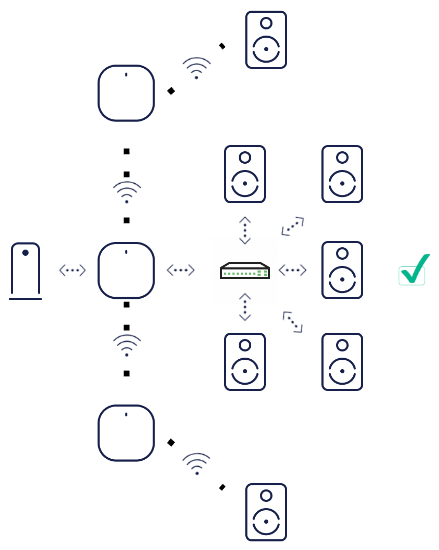

Mixed Wired and Wireless Sonos:
An image with a suggest topology with a modem connecting to a Gateway eero. That eero connects to two other eeros wirelessly. Each wireless eero connects to a Sonos device wirelessly. The Gateway eero also connects to a switch, which provides Ethernet connections to other Sonos devices.
