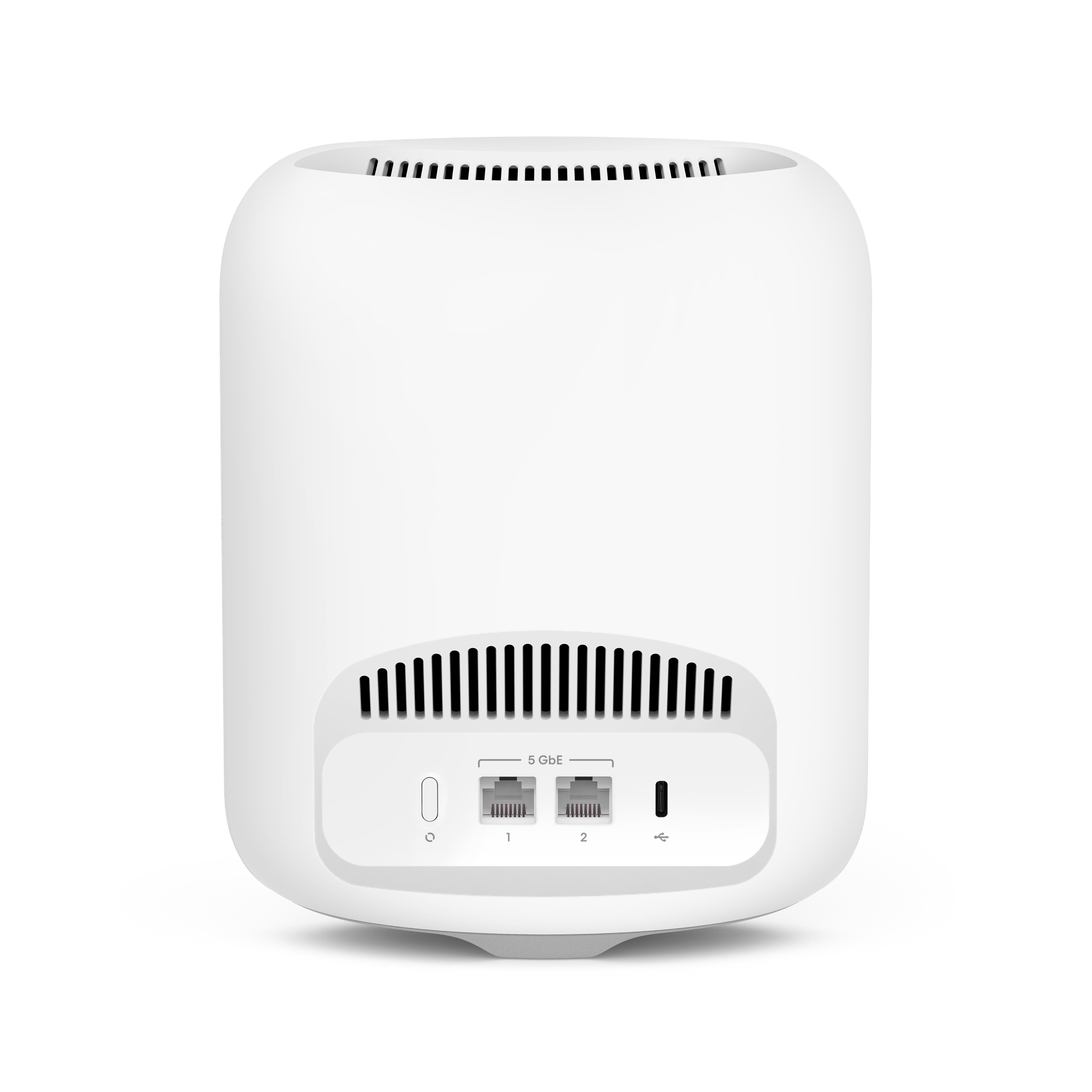

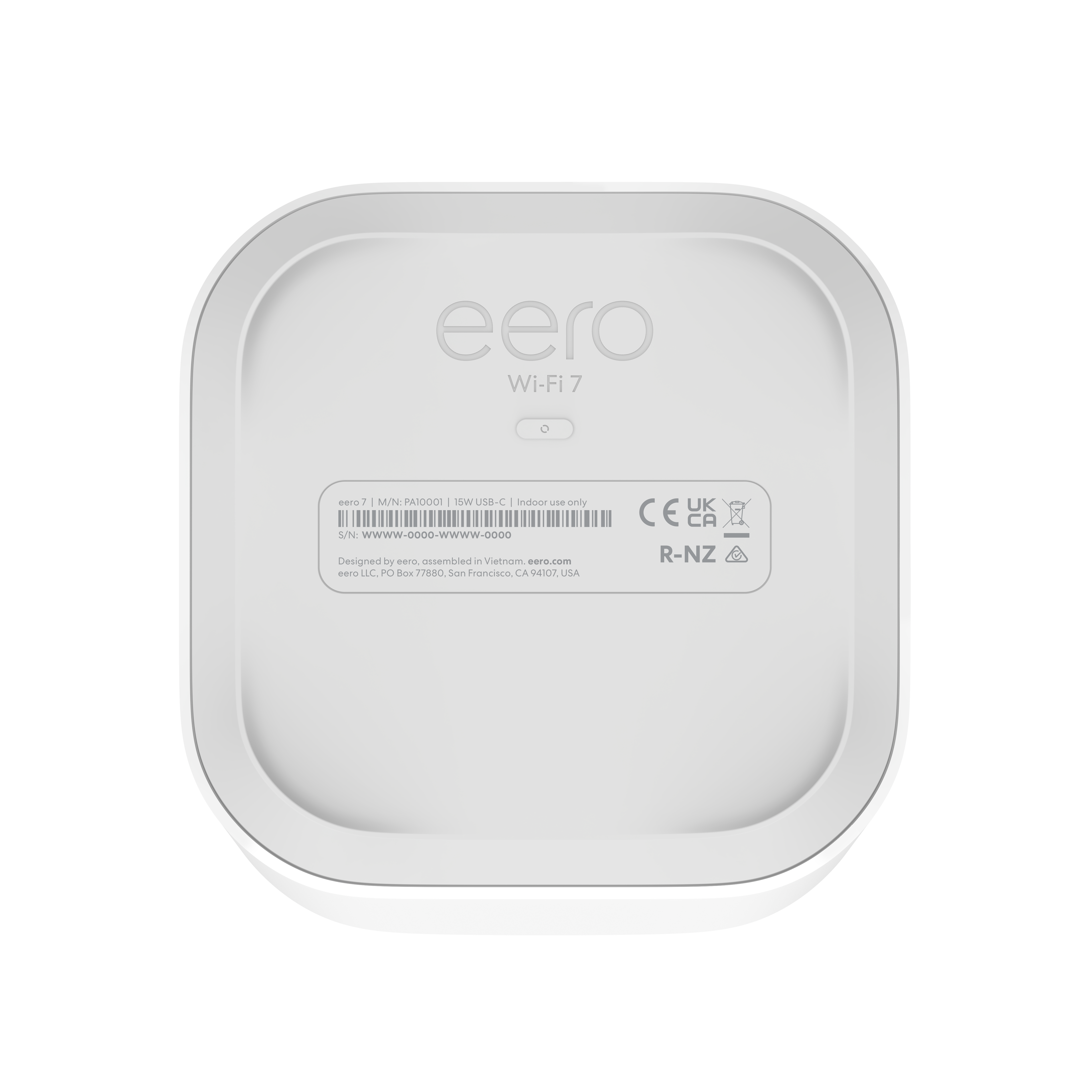

Where is the reset button located?
eero (1st generation) and eero Pro: The reset button is located on the back of the device. eero (1st generation) has an inset pinhole reset button, eero Pro has a small oval button.
eero Beacon: The reset button is located on the side of the eero Beacon. It's a small oval button.
eero, eero 6, eero 6 extender, eero 6+, eero Pro 6, eero Pro 6E, and eero 7: The reset button is located on the bottom of the device. It's a recessed, oval button.
eero PoE 6, eero PoE 7: The reset button is located on the back of the eero PoE 6. The eero must be removed from its mounting bracket to access the reset button. It's a small, oval button.
eero PoE Gateway: The reset button is located on the back of the eero PoE Gateway. It's a small, circular button.
eero Max 7 and eero Pro 7: The reset button is located on the back of the device. It's a small, oval button.
eero Outdoor 7: The reset button is located on the bottom of the eero Outdoor 7. It's a recessed, oval button.
Ring Alarm Pro: The reset button is located on the back of the Ring Alarm Pro. It's an inset pinhole.
