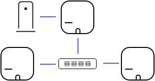

Adding an Ethernet switch
An image of the recommended topology for an eero system, where a modem connects to an eero gateway via Ethernet. This eero gateway then connects via Ethernet to a network switch, which branches off to connect to two additional eeros via Ethernet.
If you'd like to connect additional devices via Ethernet to your gateway eero, as well as additional eeros, you can use an Ethernet switch to expand the number of available ports on your eero network. In this scenario, a switch can be connected to the gateway eero, and additional eeros can be connected to it via Ethernet. You can also use a switch off of any other eeros.
