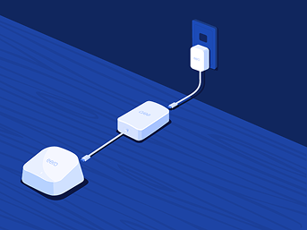

  1. Identify the eero nearby the landline device you wish to connect
  2. Connect the adapter to the USB-C port on the back or underside of your eero. Connect the eero’s power adapter to the open USB-C port on the adapter.
    eero device connected to an eero Telephone Adapter plugged into a wall outlet.
  3. The eero will reboot after being plugged into the Telephone adapter and PSU. The eero will be completely reconnected when the LED changes from blinking white to solid white.
    • This can take up to 90 seconds
