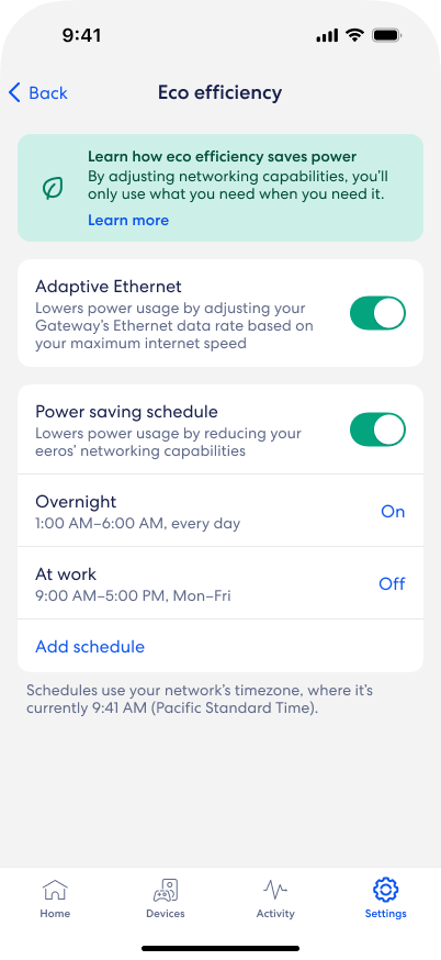

How do I  set up Power Saving Schedule?

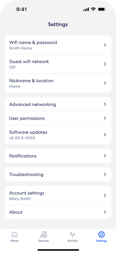

  • Open the eero app and go to Settings > Advanced networking.
  • Scroll to the Network services section and select Eco efficiency.
  • Toggle Adaptive Ethernet on to enable power saving.
  • Toggle Power saving schedule “on” to set when Power Saving Schedule should automatically activate.

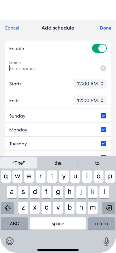

  • Select Add schedule to create a custom schedule, or choose from pre-set times.
  • When setting a custom schedule, enter a name for your schedule and select at least one day.
  • Tap Save to activate your schedule.
You can create multiple schedules that run at different times. For example, you might set one schedule for overnight and another for weekday work hours.

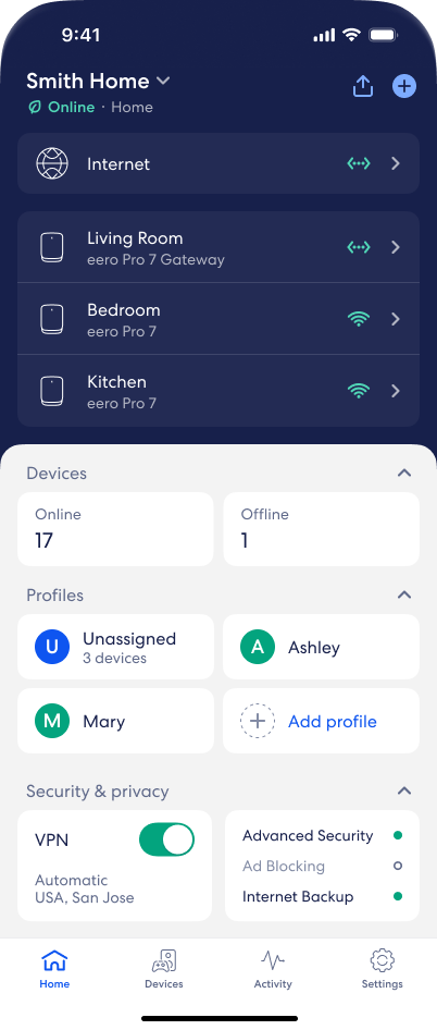

Verify status in the app
Use the eero app to quickly verify that SPS is active on your network. The app will display a green “leaf” icon at the top of the home screen whenever power saving is enabled.
