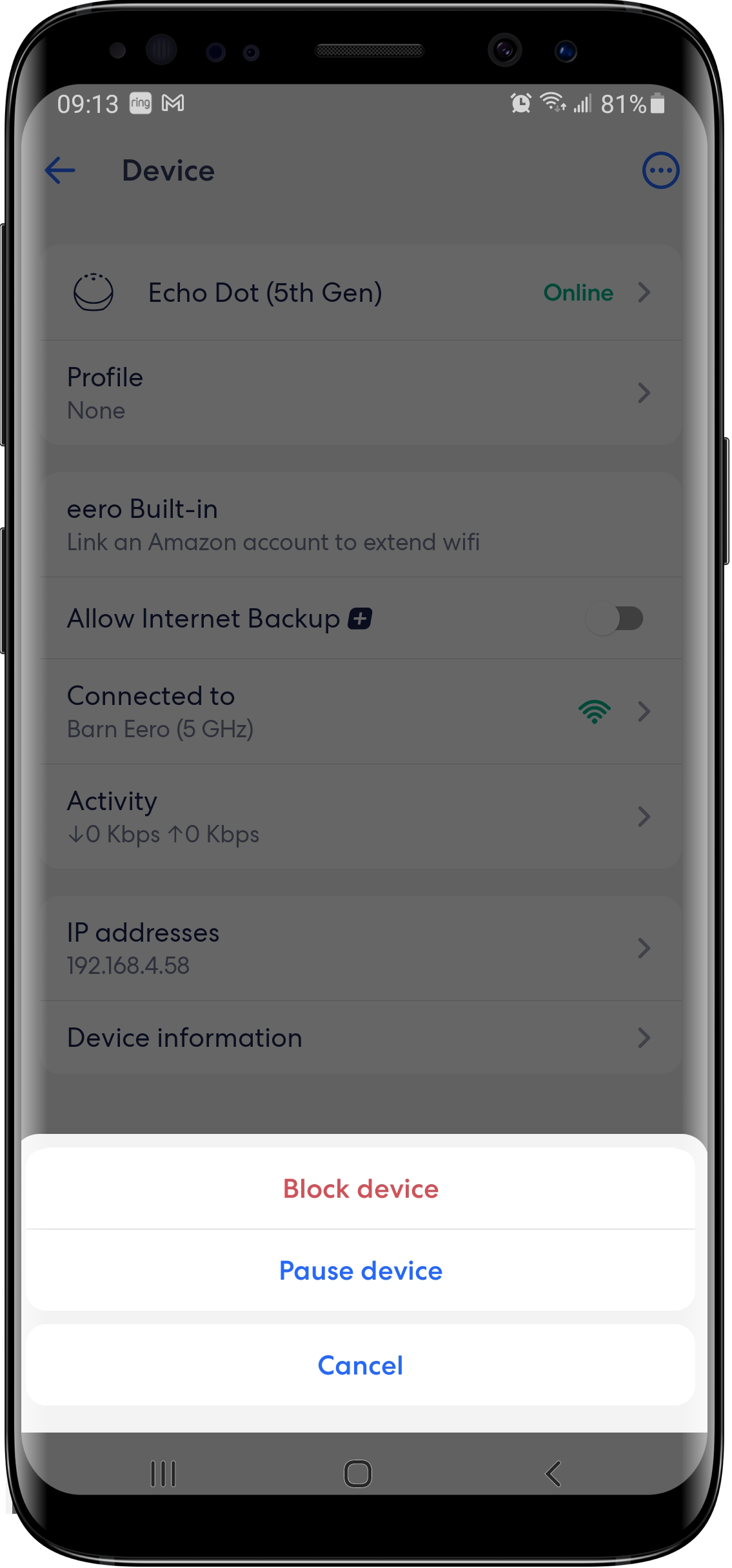

You can tap on any device on this list, press the three dots in the upper right corner and select Block Device to disable network access on that device.
An image indicating that the location of the Block option is in a device's details page.

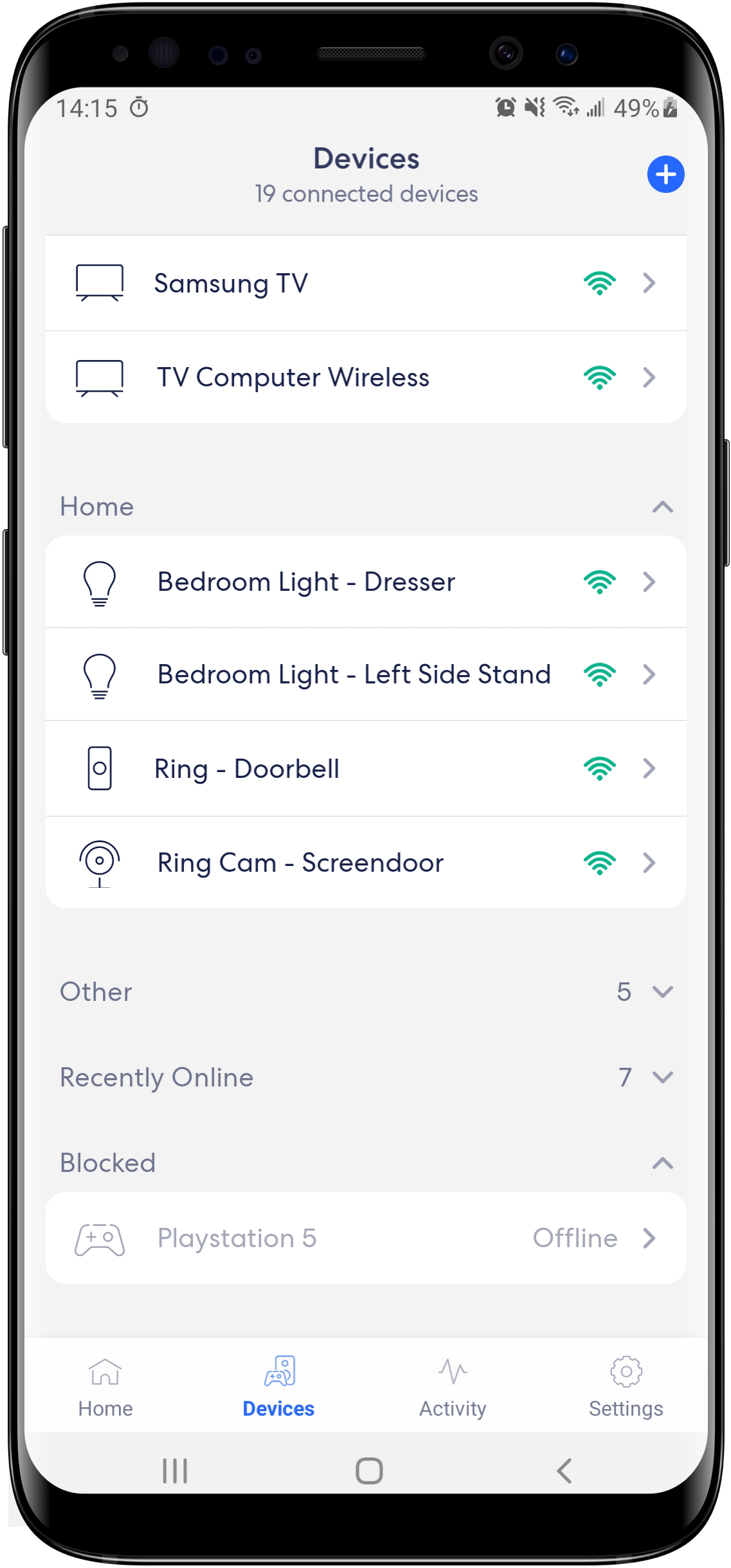

Blocked devices will now appear in a new list that populates at the bottom of the Devices tab. You can tap on any device on this list, select the three dots in the upper right corner and select to unblock. This will remove it from the block list and re-enable network access.
An image indicating where to find Blocked devices in the Connected Devices list.
