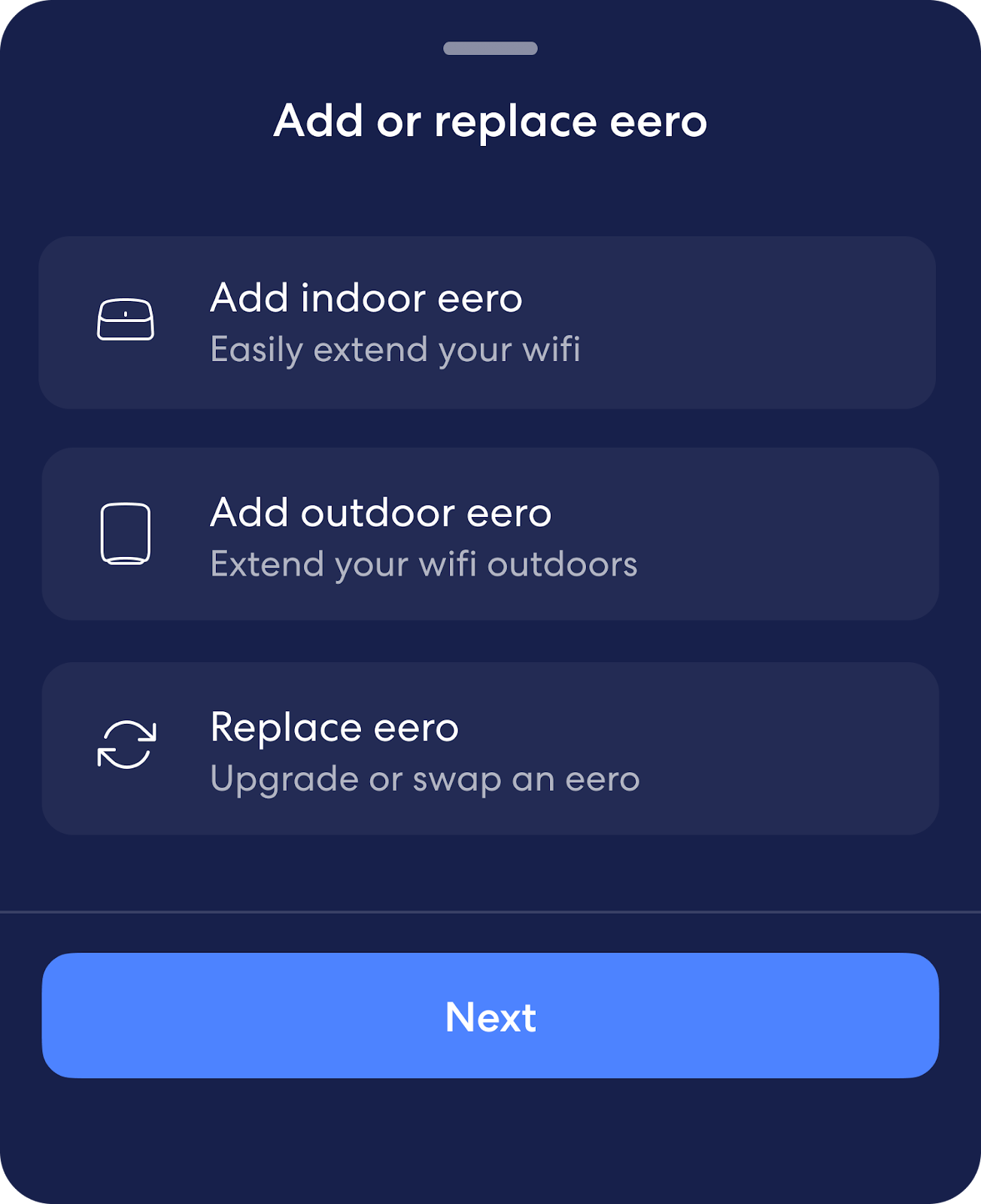

  • Tap the (blue plus icon) on the top right
  • You'll see three options to select from:
  • Add indoor eero - Easily extend your wifi
    • This option is used to add an indoor eero to your existing eero network.
  • Add outdoor eero - Extend your wifi outdoors
    • This option is used to add an outdoor eero to your existing eero network. (Note: Only eero Outdoor 7 is currently rated for outdoor use)
  • Replace eero - Upgrade or swap an eero
    • This option is used to replace an eero on your existing eero network.
  • Once you’ve selected one of the available options, click the Next Button.

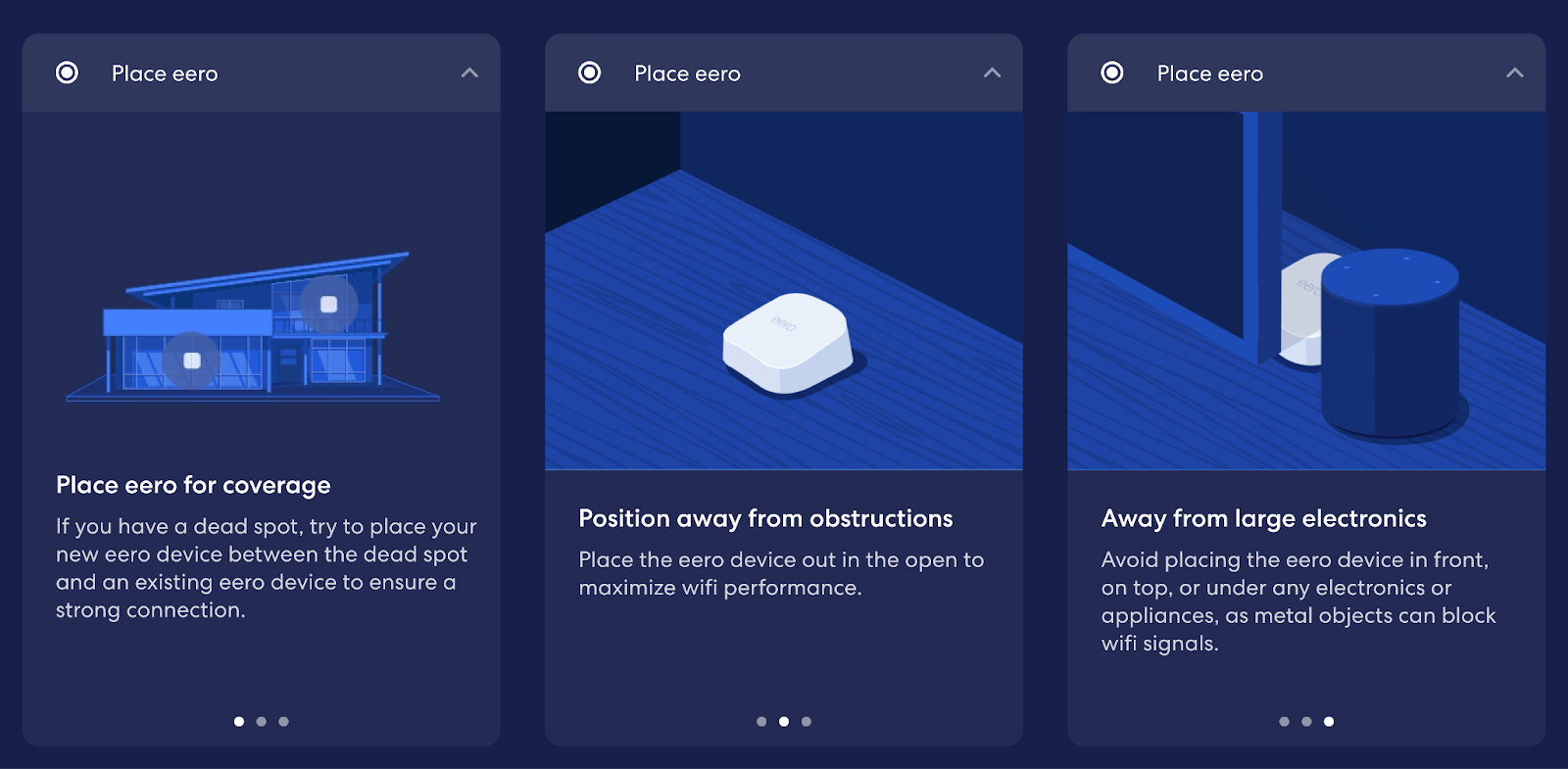

Place eero:
If this is your first time setting up a secondary eero, the app will walk through three placement tips to help in picking the optimal placement. If you have multiple eeros on your network, the app will skip these tips.
  • Place your eeros for coverage
  • Position away from obstructions
  • Away from large electronics

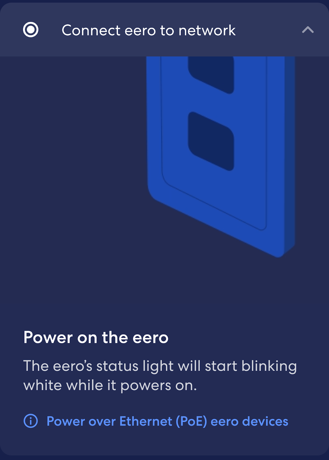

  • Plug the eero into power (Blinking White LED)
    • The app will display information for confirming the eero has power, as well as a link to more information about our power over ethernet devices.

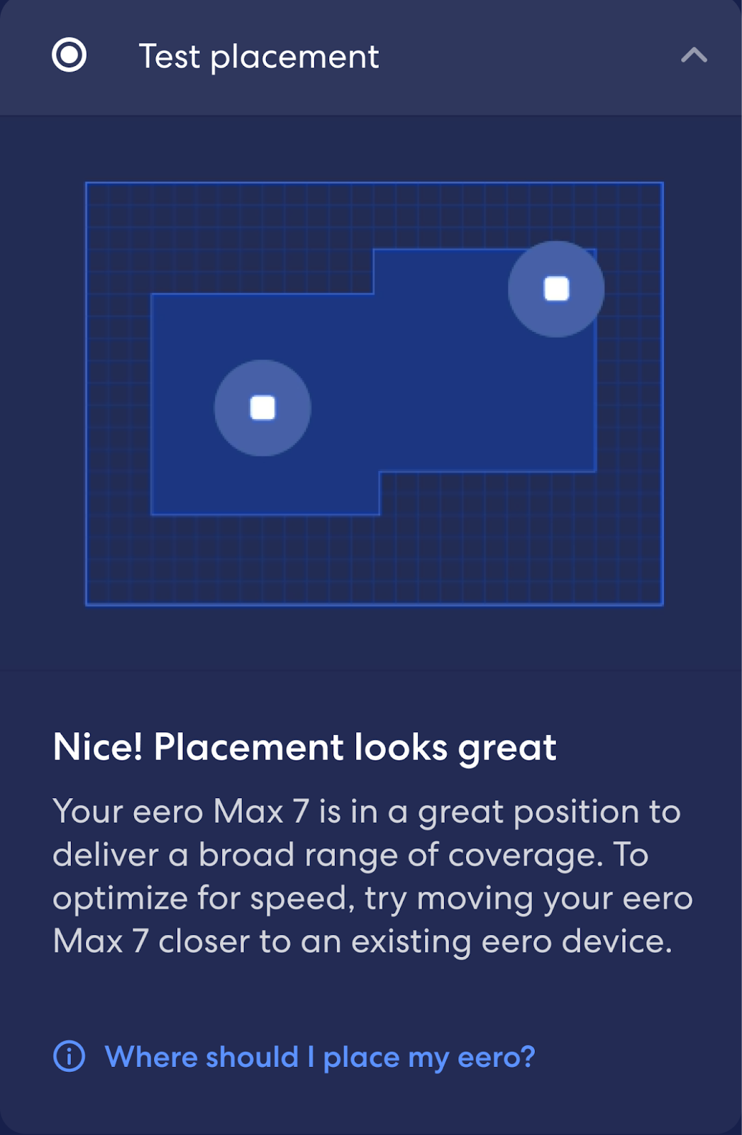

Test placement:
The app will run a placement test to measure the wireless signal of the eero. It will produce three results:
  • Nice! Placement looks great
    • The eero is receiving a strong signal.
  • Placement could be better
    • The eero is receiving a signal, but it could be better. Try moving the eero closer to another eero device.
  • The eero is out of range
    • The eero isn’t receiving a connection. Try moving the eero closer to another eero device.

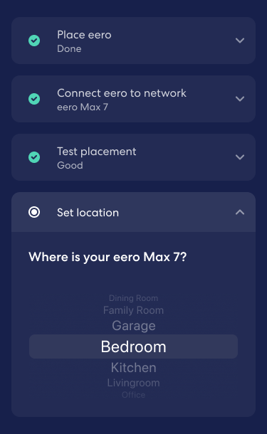

Set location:
Next, the app will ask you to choose a location name for the eero. This can be chosen from our curated list of room names or you can scroll down to ‘Custom location’ to provide your own. For the best experience, we recommend naming your eero devices unique location names to avoid confusion.

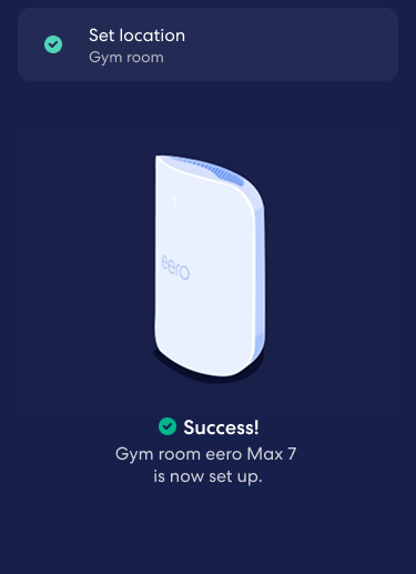

Registering:
Finally, the app will register and add the eero to your network.
Success! Once your eero device has been added to the network, you can choose to add another or finish setup.
