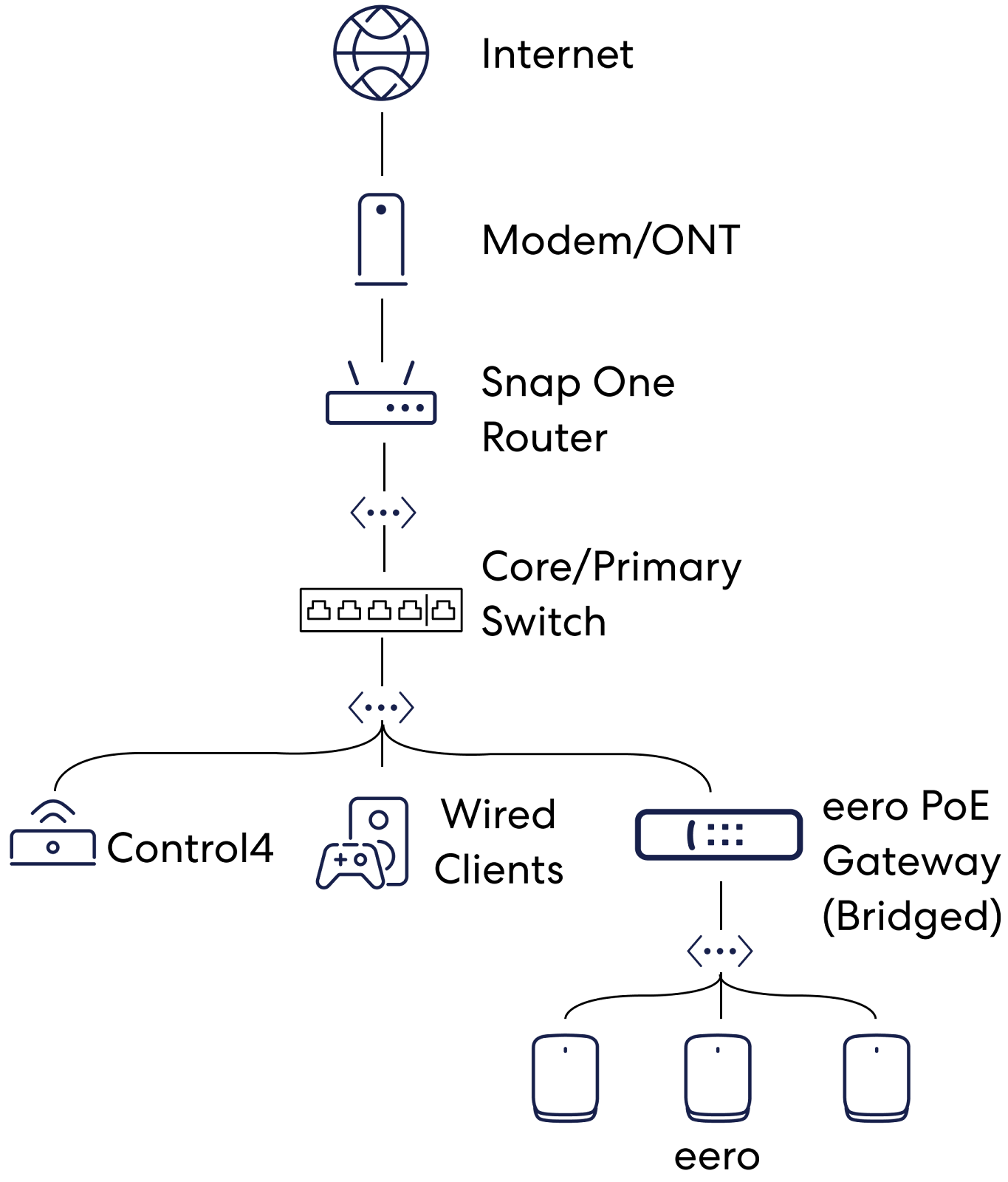

eero with Control4
In this configuration, eero serves as the primary router for the network, with other eeros and any Control4 equipment hardwired to the gateway eero through a network switch.
An image of a suggested topology where the modem connects via ethernet to eero. That eero connects via ethernet to a switch, which then connects via ethernet to two other eeros and a Control4 device.

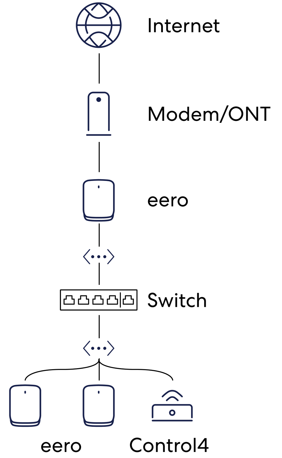

eero PoE Gateway Setup
This configuration uses an eero PoE Gateway instead of a standard eero to eliminate the need for additional network switches. The eeros on the network are configured for bridge mode to allow the Snap One router to manage DHCP.
An image of a suggested topology where the modem connects via ethernet to a SnapOne router. That router connects via ethernet to a switch. Te switch provides ethernet connects to a Control4 device, an eero PoE Gateway in Bridge Mode, and various other ethernet clients. The eero PoE Gateway connects to additional eeros via ethernet.

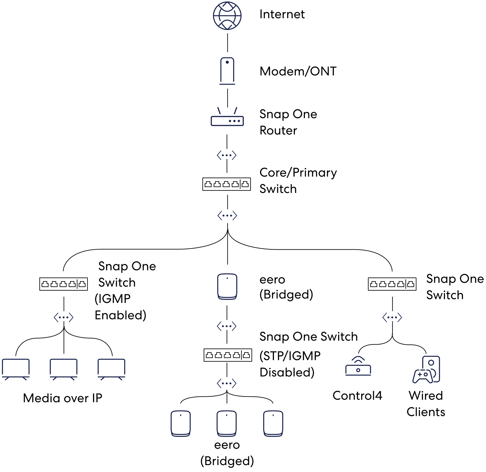

Snap One router with eeros and MoIP
This setup has multiple switches meant to serve bridged eeros, Control4 and wired clients, and a dedicated switch for Media over IP (MoIP).
As mentioned above, MoIP requires IGMP to be enabled, necessitating an additional switch to isolate it from the rest of the network.
An image of a suggested topology where the modem connects via ethernet to a SnapOne router. That router connects via ethernet to the main switch. The main switch has three ethernet connections. First, it connects to a SnapOne switch with IGMP enabled, which connects via ethernet to various Media Over IP devices. Second, the main switch connects to an eero router in Bridge Mode, which connects to another SnapOne switch with IGMP disabled, which then connects via ethernet to additional eeros. Finally, the main switch connects to a third SnapOne switch, which connects to a Control4 device and other various devices.
