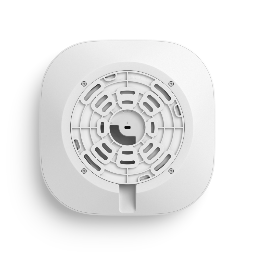

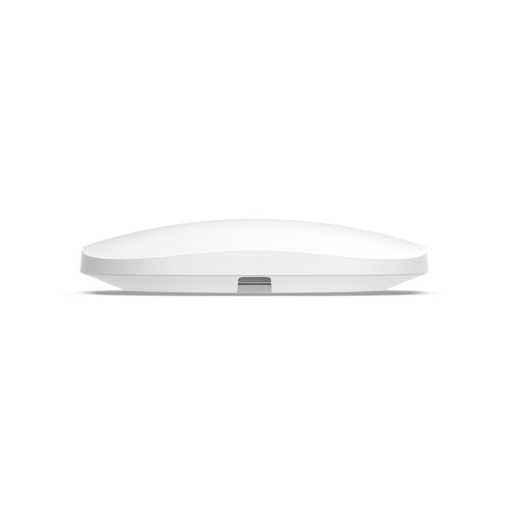

Top of the eero PoE 7 Side view of the eero PoE 7 Back view of the eero PoE 7
