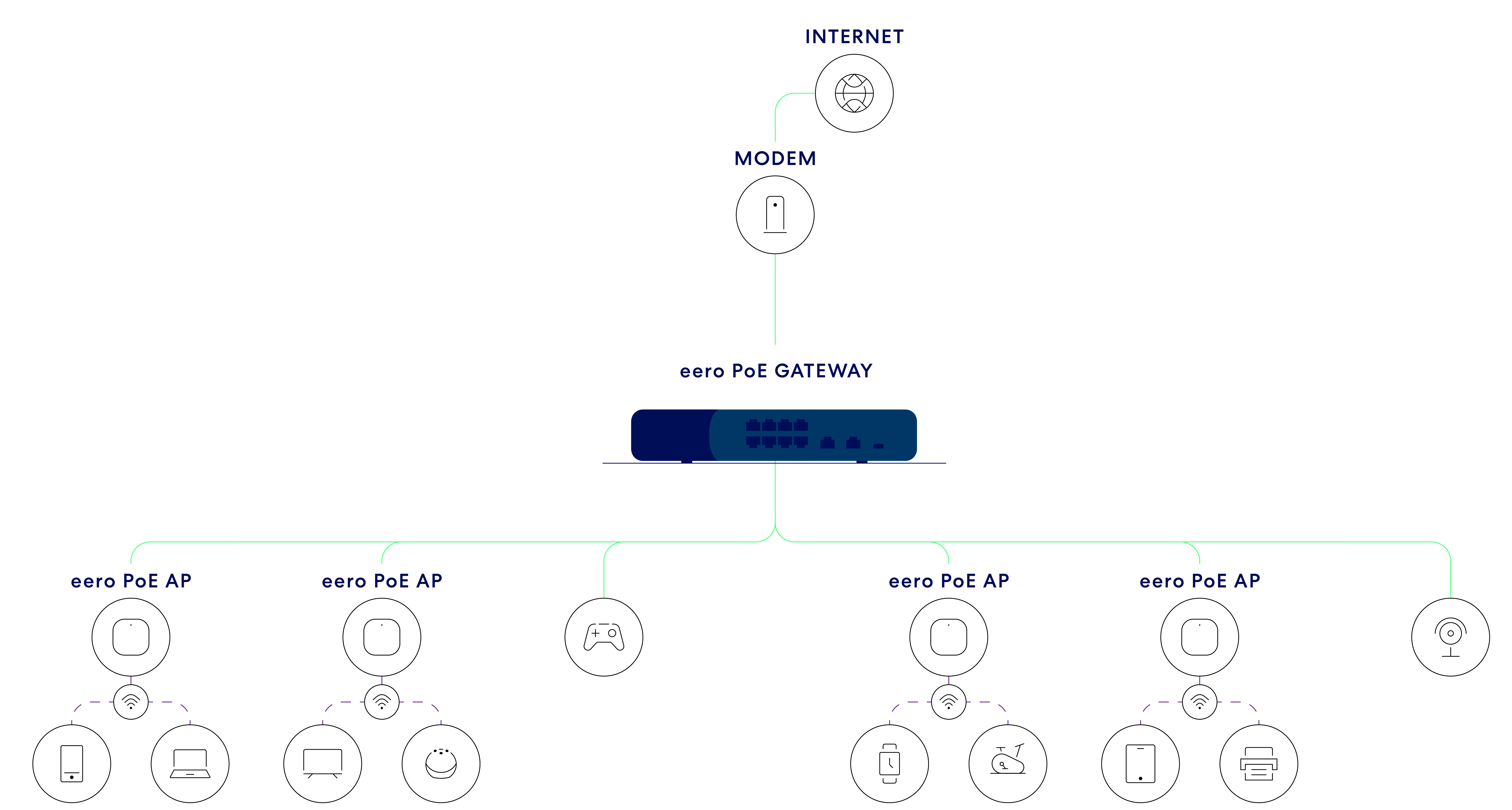

Recommended network topology
An image of the recommended topology of an eero network when using an eer PoE Gateway. The modem connects to the eero PoE Gateway, which then connects to several eero PoE 6 units. Each eero PoE 6 then connects to other devices.

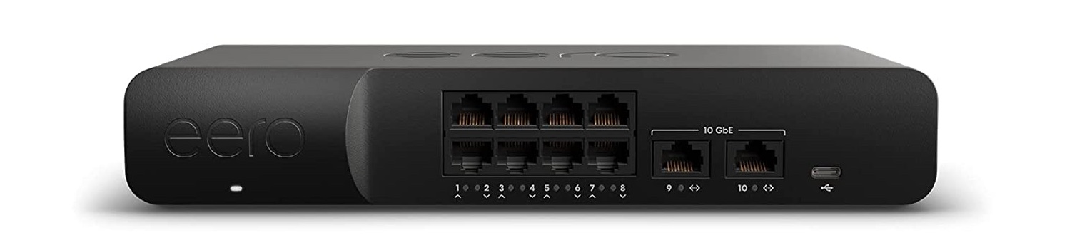

The eero PoE Gateway is capable of powering up to 7 eero PoE6 access points.
The eero PoE Gateway has eight PoE Capable 2.5GbE ports and two 10 GbE ports.
An image of the physical appearance of the eero PoE Gateway.
*Note the eero PoE Gateway only supports wired clients and does not have wireless capability. You can add the eero PoE6 to enable WiFi for your network.
