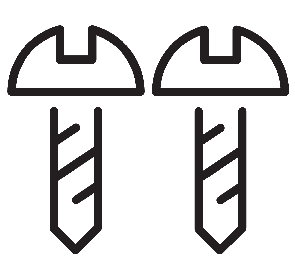

two level screws line art image Two Leveling Screws
  • Wood or Fiber Cement
  • Vinyl Siding
Two stainless steel screws, #8 (15 x 30 mm)

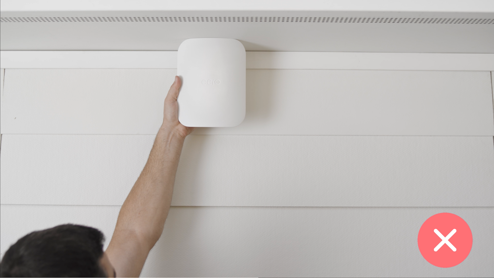

Ensure that there is at least one foot of space both above and below the mounting bracket for the eero Outdoor 7 in your desired location. Make sure that the eero is not near any obstructions, such as large trees, grills, satellite dishes, etc.
showing eero too close to home over hang
The device must be installed with ports facing downward for it to function properly and to prevent water accumulation and ingress. This is required for proper installation–failure to do so will void the unit’s warranty.

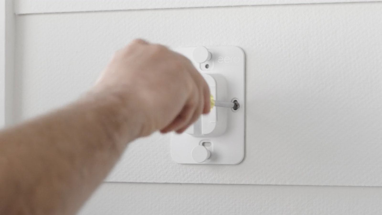

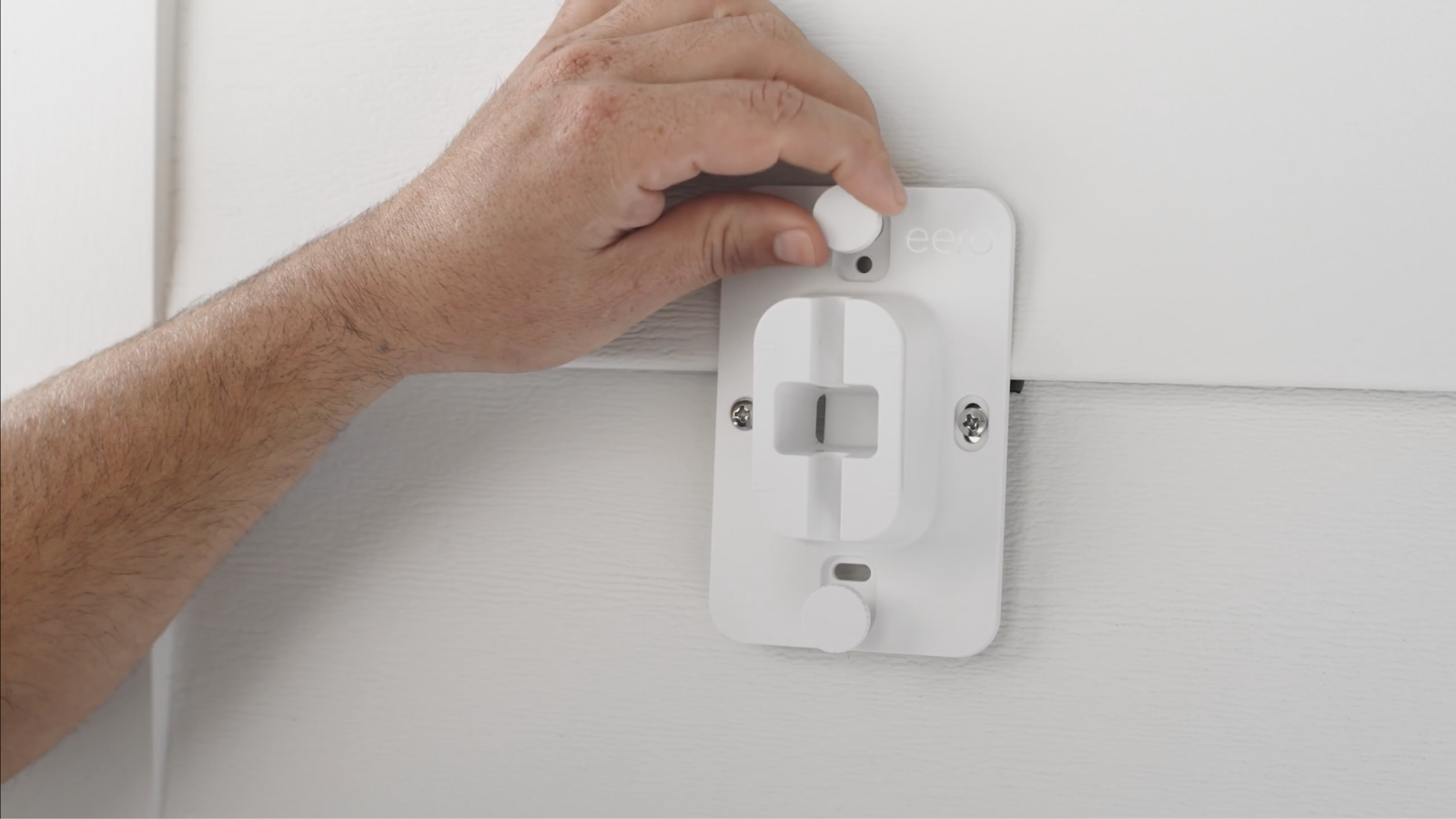

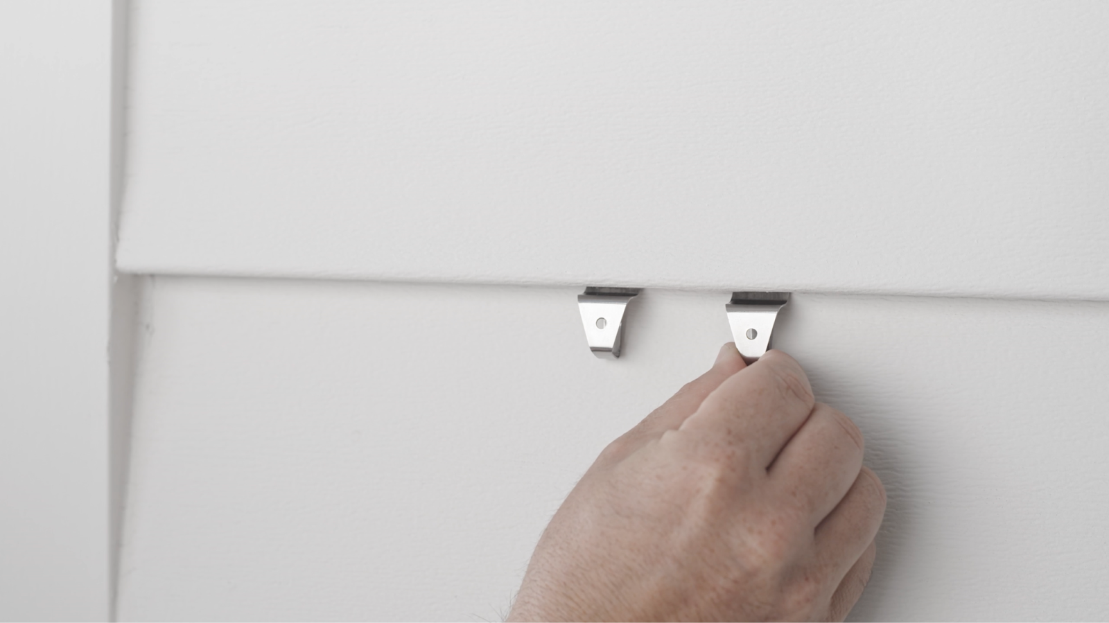

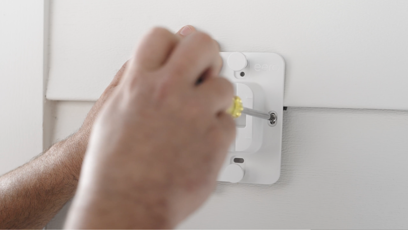

Mounting to Vinyl Siding
  1. Insert the vinyl siding clips at a joint between the signing panels where you want to place the mounting bracket.
    vinyl siding clips shown at joint between siding panels
  1. Secure the bracket to the clips with the included screws. The combination of the clips and the mounting bracket will pinch down on the siding material.
    screwing mounting bracket into siding clips
  1. Tighten the clip screws to maximize retention force, keeping the bracket in place. Make sure the eero logo on the mounting bracket is right side up.
    tightening screws in mountain bracket
  1.  Use the leveling screws to bring the back of the mounting bracket vertical. Hand-tighten at least ½ turn beyond the point where the bracket is approximately level.
    inserting leveling screws into mountain bracket

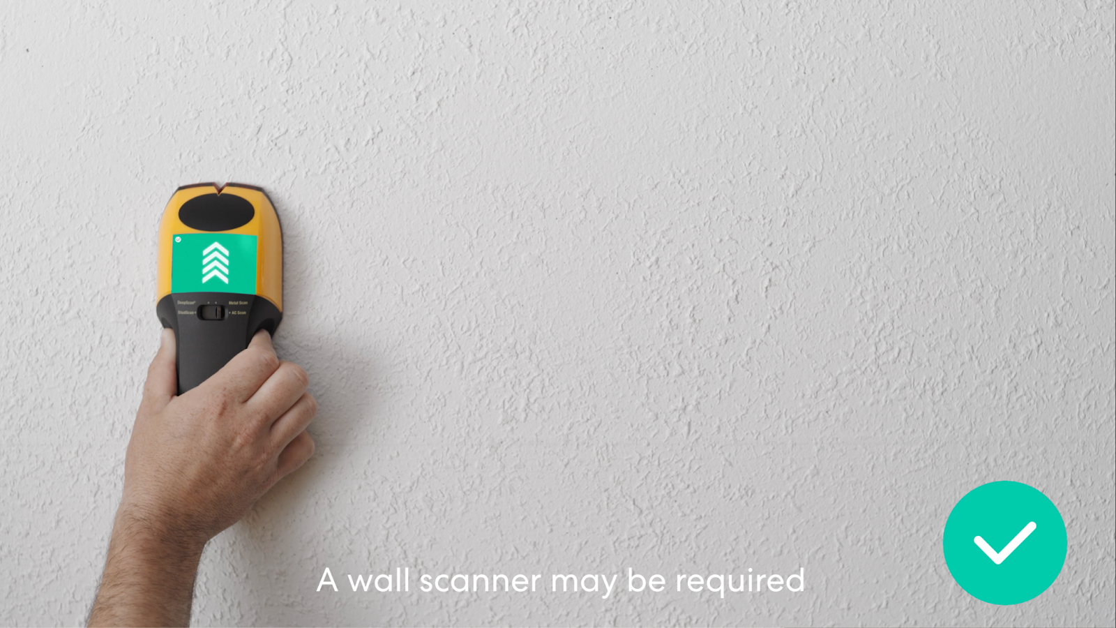

wall scanner searching for stud
Prior to attaching the mounting bracket to your chosen location, be sure to check for hidden wires or pipes.
Make sure to avoid damage to these when drilling holes to install the mounting bracket. If the surface is uneven, you can use the leveling screws to adjust the angle of the eero.

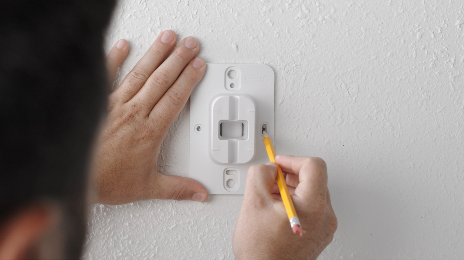

using mounting bracket to mark screw placement with pencil on wall
Use the mounting bracket to mark where the screws will be placed, and a level to align the unit (interior holes are spaced approximately 3 1/4' apart). The eero logo on the mounting bracket should be right side up.

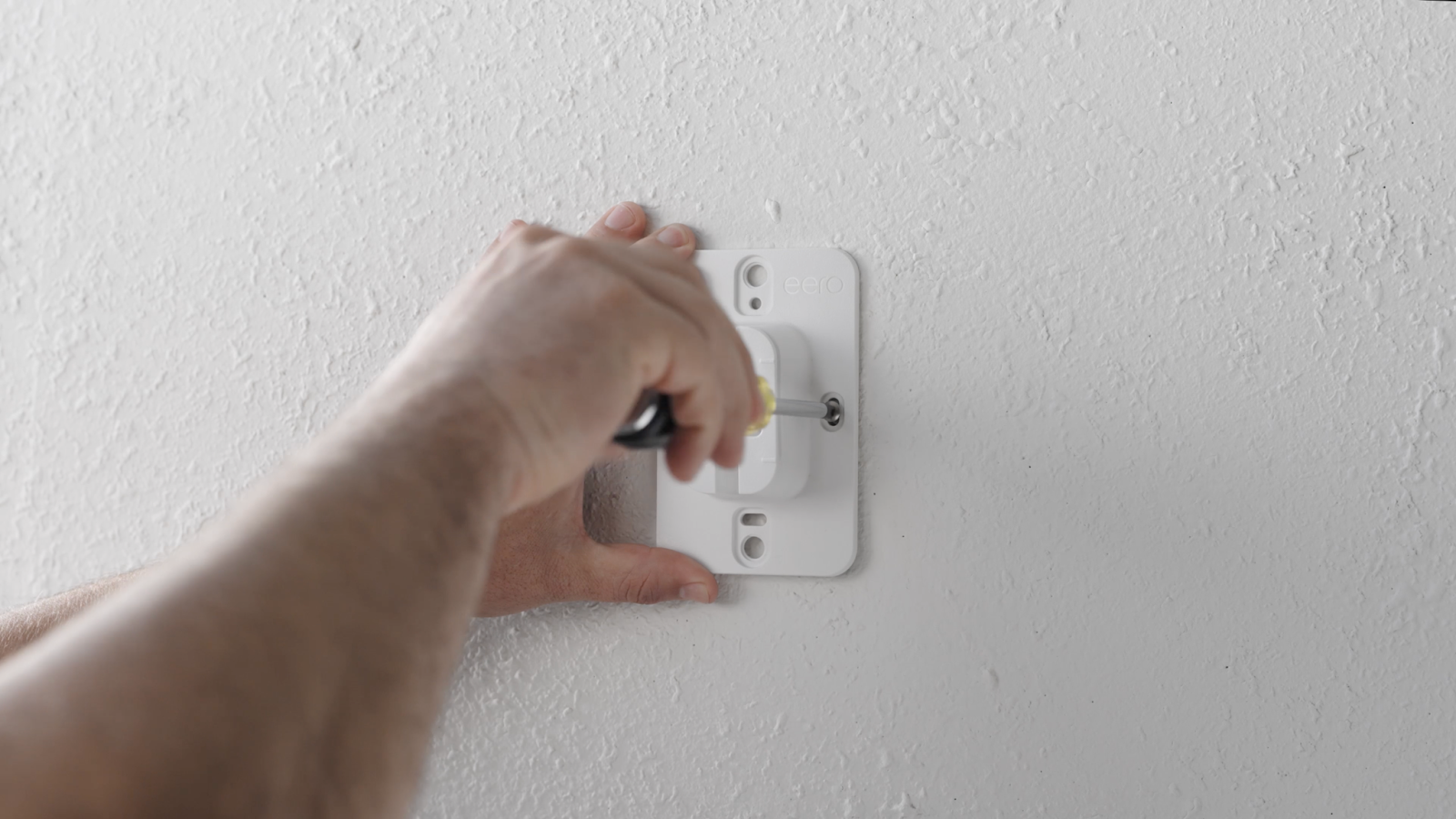

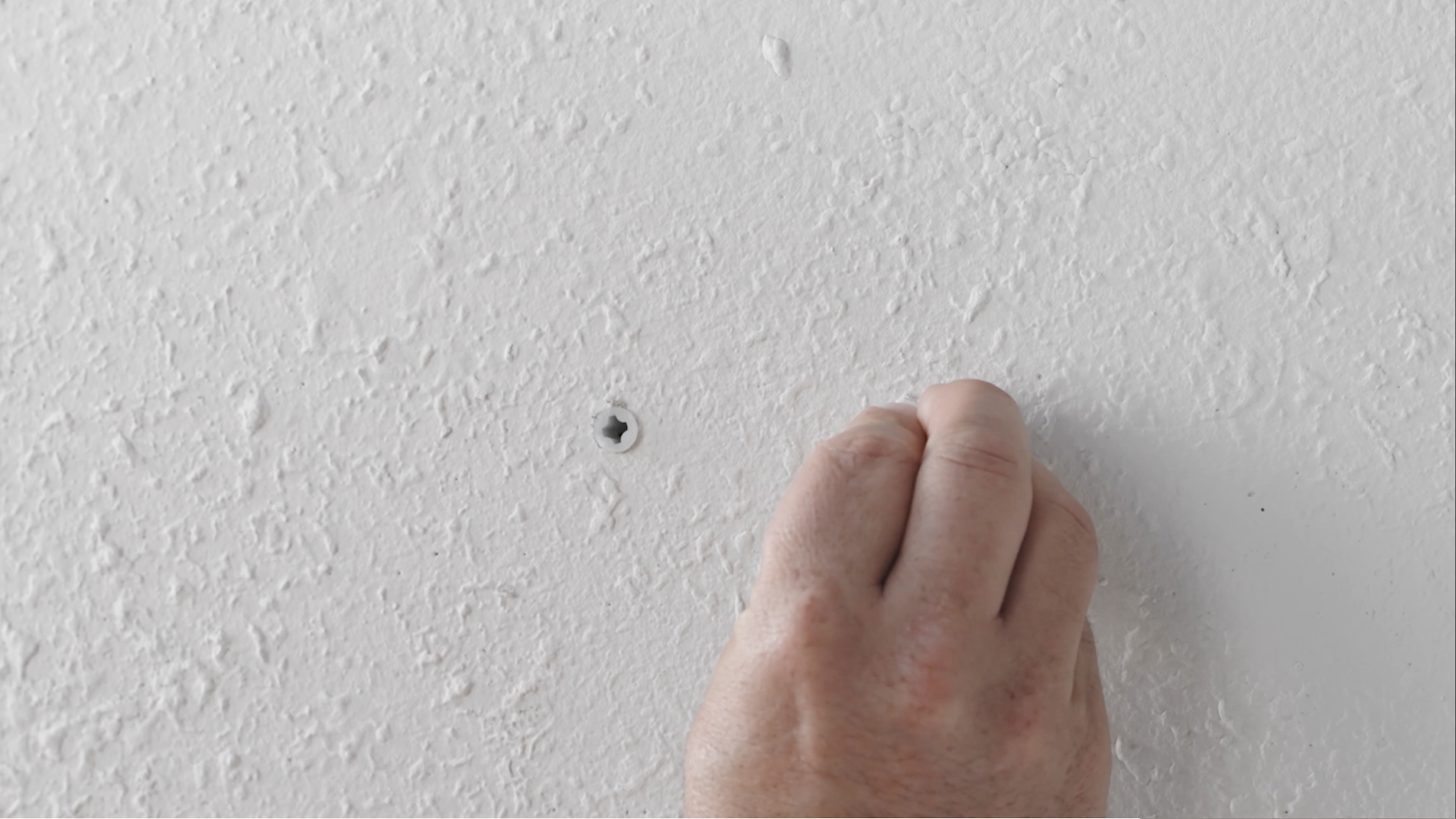

Stucco
  1. Drill pilot holes. Pilot holes should be 1/4 in. size for the provided anchors and screws
    drawing initial holes in wall
  1. Insert drywall anchors.
    inserting drywall anchors
  1. Use the screws to attach the mounting bracket to the anchors
    attaching mounting bracket to wall with screws

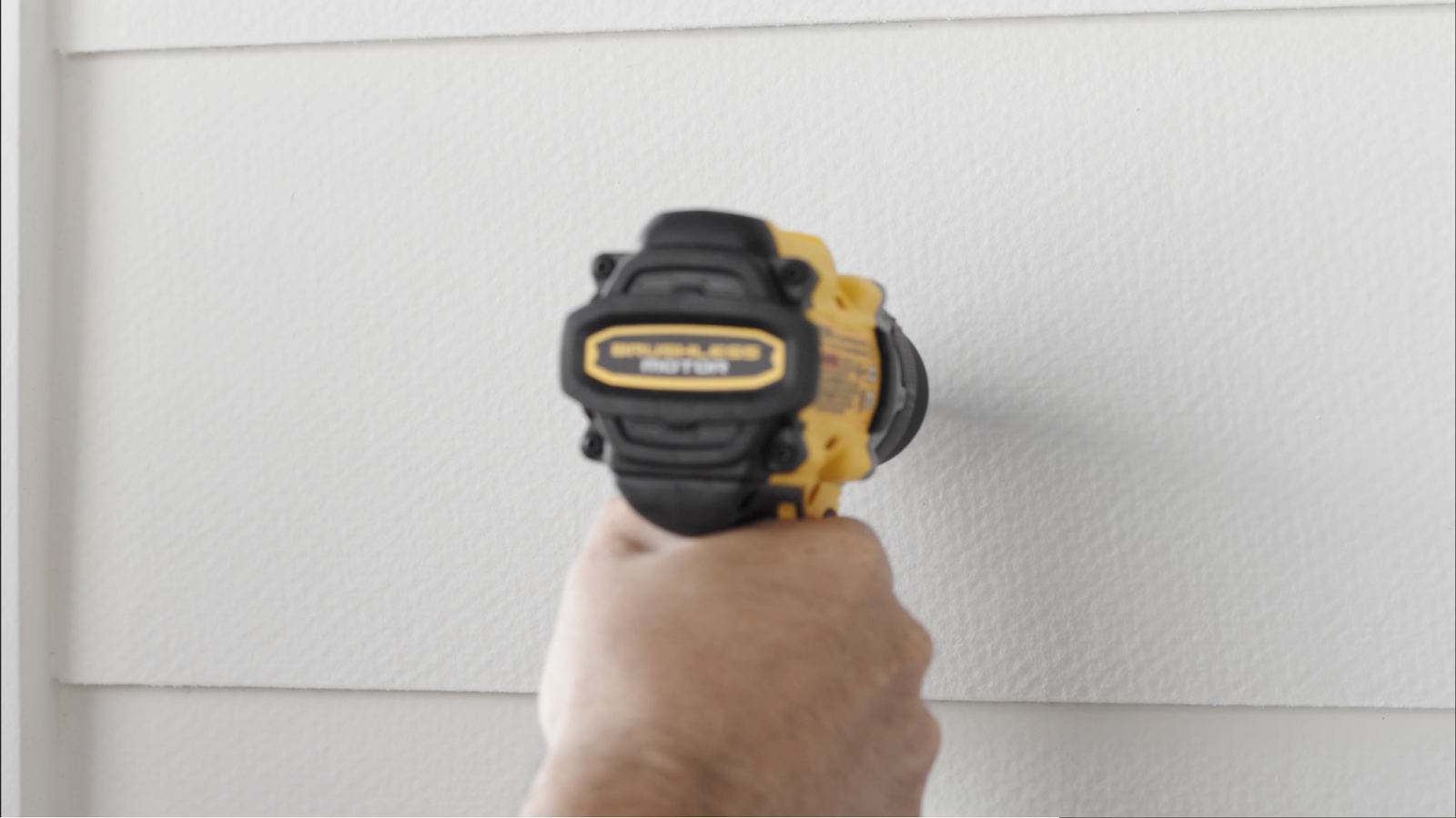

    drilling pilot holes

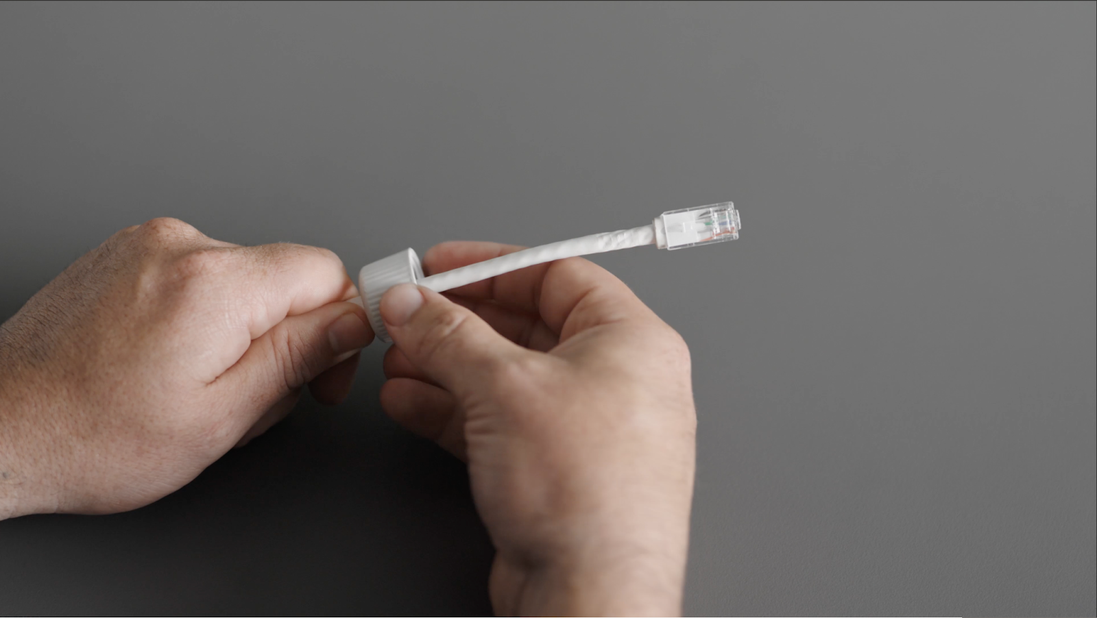

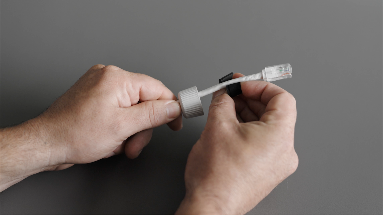

Sealing the Ethernet Cable
The Ethernet cable connected to the eero Outdoor 7 should be sealed to protect from excess dirt or moisture. The Ethernet cable must have a round jacket, and be rated for outdoor use.
If you’re using the eero 30W PoE+ power adapter, the sealing nut will come wrapped around the adapter out of the box. Otherwise, follow the instructions below to seal the Ethernet cable:

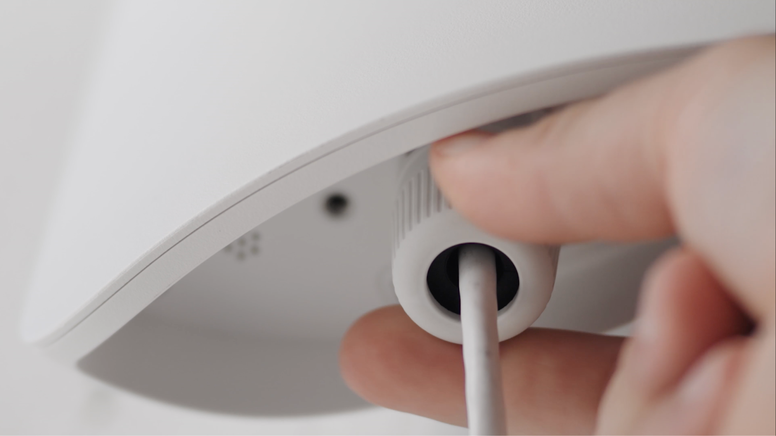

  1. Insert the Ethernet cable through the sealing nut.
    pulling ethernet cable through sealing nut

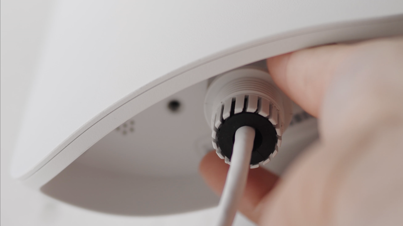

  2. Pull open the seal to wrap around the cable, then push the cable through the body of the connector.
    wrapping seal around ethernet cable
  3. Once your cable is through the body, push the seal inside the prongs of the body.
    pushing seal into prongs of body

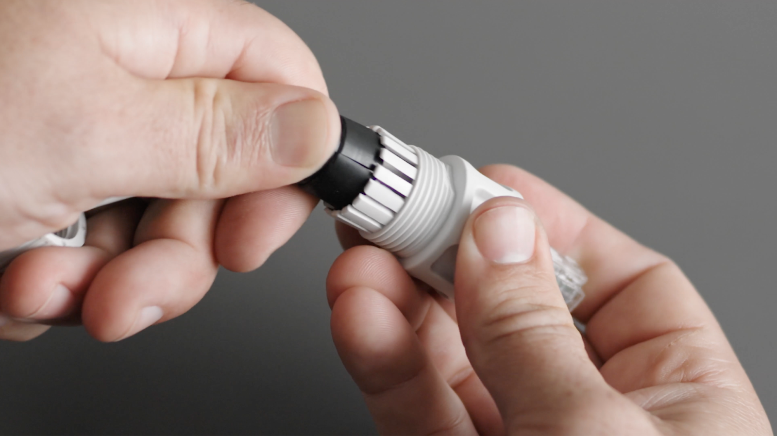

  4. Plug in Ethernet cable. Screw the M22 connector into the eero Outdoor 7. Hand-tighten until the cable is sealed.
     connecting M22 connector to eero outdoor 7
  5. Hand-tighten the sealing nut onto the body of the M22 connector.
    tightening sealing nut to weatherproof connection

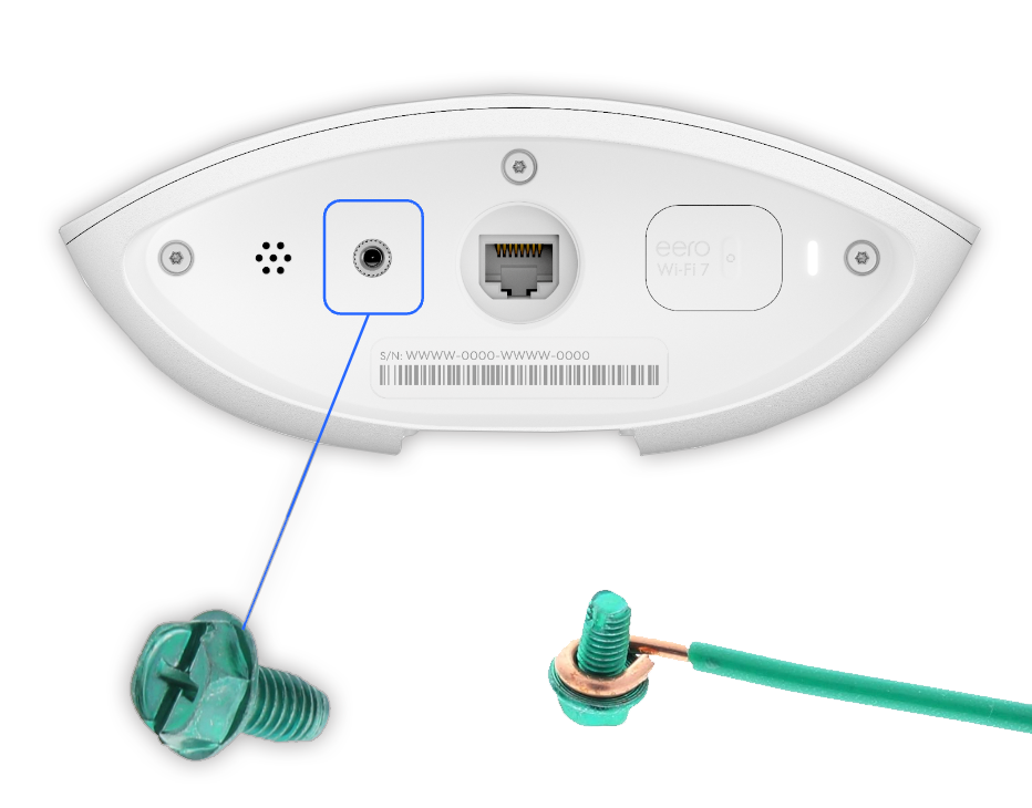

Grounding the eero Outdoor 7 (If Needed)
If desired, or required by local electrical code, the eero Outdoor 7 has provisions for grounding to handle lightning-induced power surge events. In environments with frequent electrical surges, grounding the eero Outdoor 7 is recommended. Grounding wire is not included.
Connecting grounding cable to eero Outdoor 7
Both the eero Outdoor 7 and the 30W Outdoor PoE+ power adapter have an M4 Insert which allows a #8 bonding cable to be attached to the unit and run directly to the ground.
  • Connect a bonding cable to both the eero Outdoor 7 and the PoE+ power adapter.
OR
  • Connect a bonding cable to the eero outdoor 7 and to any other source of ground (Bonding plate, ground rod, etc.)
If you are unsure of how to properly ground the unit or are uncomfortable with cabling, be sure to consult with an electrician before proceeding.
