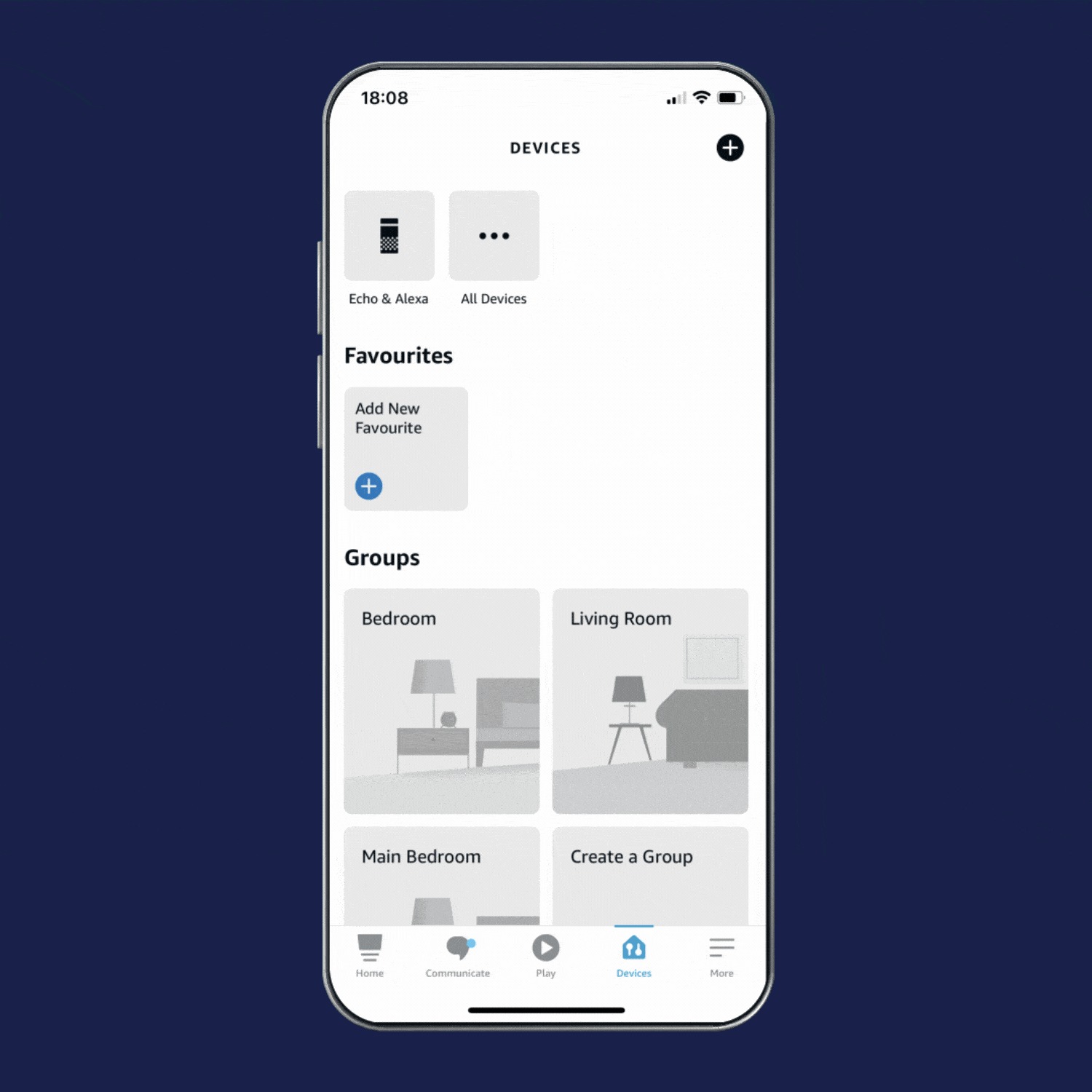

  • If you haven’t done so already, set up your Echo device in the Alexa app.
  • Make sure your phone is connected to the eero network.
  • Plug in your Echo device.
  • Open the Alexa app.
  • Open “Devices” and click on the upper right “+” to add a device.
  • Select Amazon Echo.
  • Select Echo, Echo Dot, and more. Follow the instructions to set up your device.
  • Open More and select “Add Device.”
