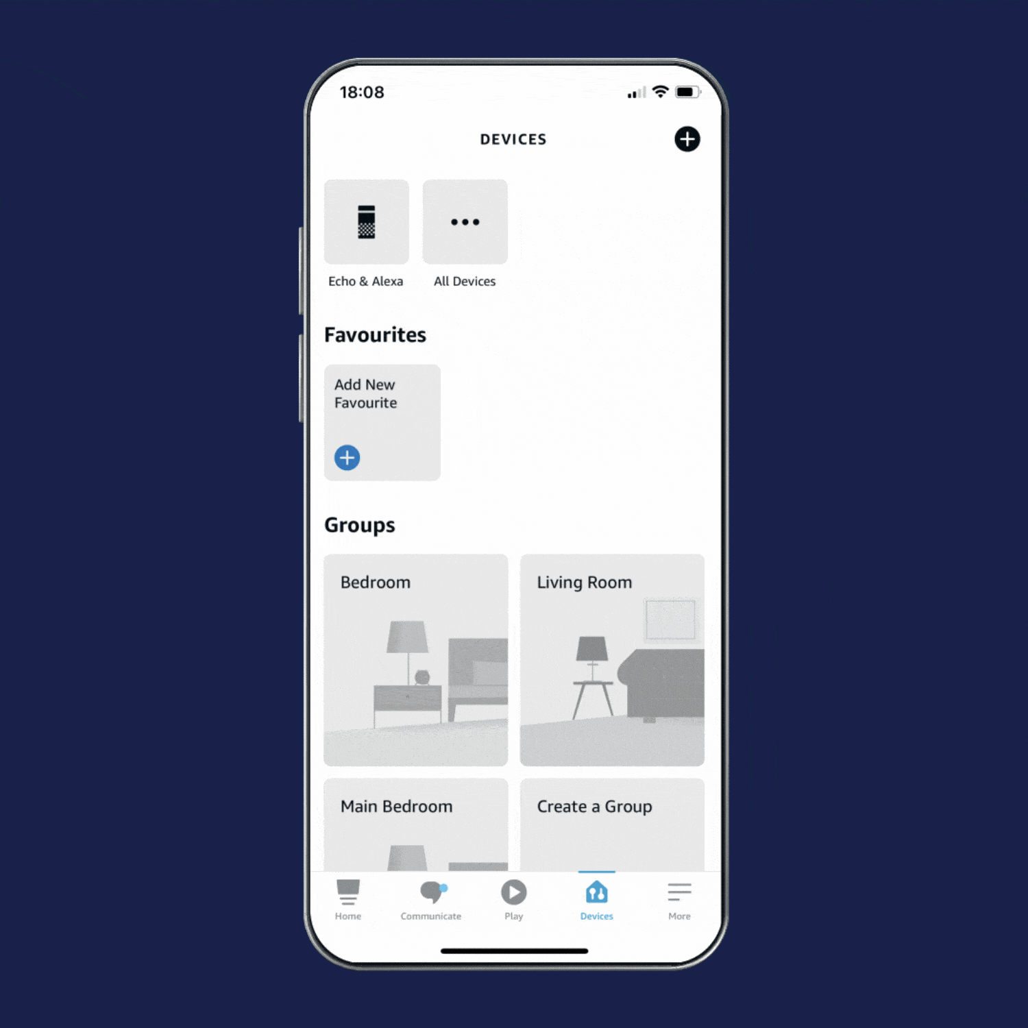

  1. Open the Alexa app
  2. Select Devices
  3. Select Echo & Alexa
  4. Select your device
  5. Select Change next to Wi-Fi Network and follow the instructions in the app
